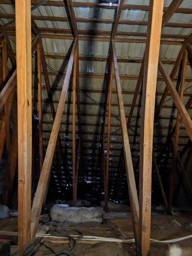

hi, any advice appreciated, as you can see from the photo my roof has no insulation under the tiles and the up stairs of my house gets very hot and I'm guessing this is the reason, also it gets very noisy from the traffic on the road outside. Was thinking something like polystyrene sheets might help with both noise and heat or what would you guys recommend, budget is small as we've just purchased the property but I also don't want to waste my time on something that won't work.

To clarify, the insulation that has been installed previously may have compressed over time and be of a low R value so it would be worth having assessed by an insulation installer to determine whether it needs to be replaced and is the likely cause of the hot temperatures upstairs.
Some heat in the roof cavity is expected and it can be managed with the use of roof ventilation but if it is transferring through the ceiling into the upper level of the house, the current insulations viability should be assessed.

I see @JacobZ has provided some good information on potential reasons for the high temps and noise. I just wanted to let you know that insulation isn't normally installed under roof tiles, and you'd only typically see a thin metal sarking. If you do not see acceptable temperatures in the room beneath the attic with your current insulation, then it is likely inadequate and needs to be replaced.
Adding additional foam insulation could be an answer, or you might find it more cost-effective to increase the R-value of the current insulation by swapping it out.
