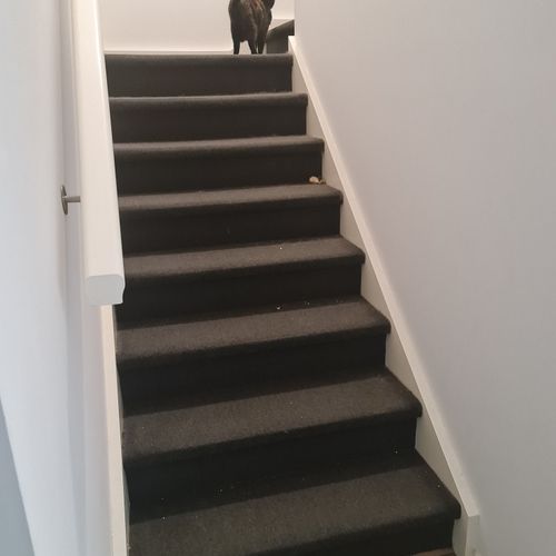

Hi! I hate carpet on stairs. With 4 cats it is a nightmare to keep clean.
I have inspected them and they seem to be MDF, I am planning on removing carpet and painting them white and black.
Now the white risers are easy enough I will probably just match them to the trim. However I dont know what to use for the black, what sort of paint should be used?
Tips for making it non slip? (I might just use a non slip tape or something.
Thanks!
(If anyone has done similar and can post pics that would be fab, google just has solid wood ones that are stained)

I suggest having a quick look at this discussion - D.I.Y. internal stairs using MDF by @Clint_hayward. Preparation is the key to a successful paint job whether you are painting walls or stairs. Removing leftover adhesive, filling in staple holes and sanding the MDF to a fine finish will provide you with an ideal surface to paint.
You'll notice in the discussion that they actually used Dulux interior paint, but used Cabot's 1L Cabothane Clear Gloss CFP Floor Polyurethane mixed with Cabot's 250ml Clear CFP Hardener to provide a tough surface finish. if you are after a good grip on your stair step, I suggest looking at Safety & Anti Slip Tape. They come in different colours and a variety of finishes.

That's true that MDF will go furry if sanded too roughly. Your objective is to skim the surface to get it nice and flat. Putting on a paint primer will help in preparing the surface of the MDF.
