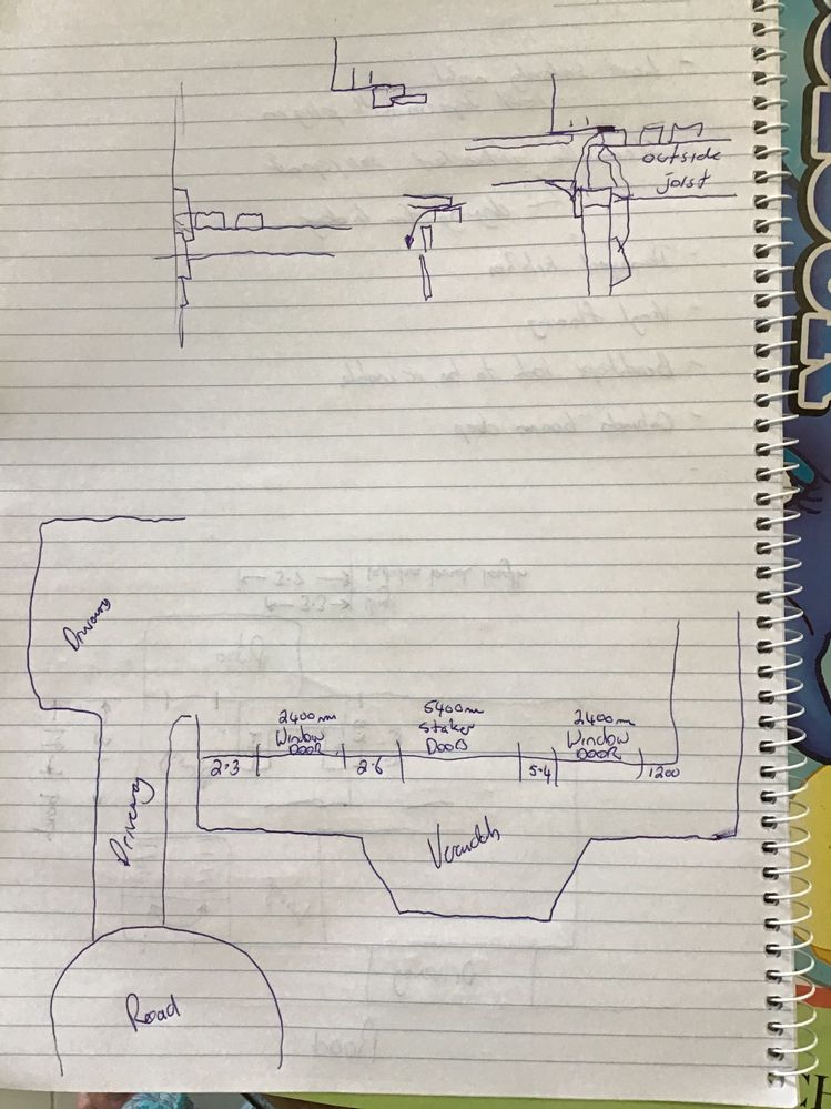

Are there any tricks I should know to fixing these leaking areas with silicone sealant? What are the pitfalls to be aware of?
Any useful, practical suggestions would be greatly appreciated!

Selleys 290ml Clear Storm Waterproof Gutter And Roof Sealant is a good example of an all around sealant. But it has a limit on how big a gap it can securely fill. It's important to assess the location and arrangement of the gap you're trying to fill.
A few things to keep in mind when filling a gap:
Another important thing to consider is if the gap is too big, I recommend using Fielders 2.4m 100mm Zinc Angle in combination with Selleys 310g Roof And Gutter Silicone Sealant - Translucent. When sealing gaps just keep in mind where the water will exit out. It's important that the water not get trapped in the area that you are sealing.
