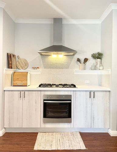

A wall in my kitchen was looking a little bare, while the bench was looking cluttered so I made some slim shelves using Pine moulding.

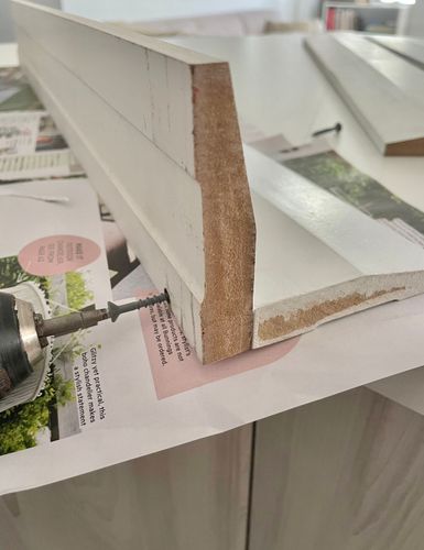

I measured & cut the moulding on an angle to create a neat corner and attached the tops & bottoms together using liquid nails & screws.
Then I painted them and attached them to the wall with liquid nails.

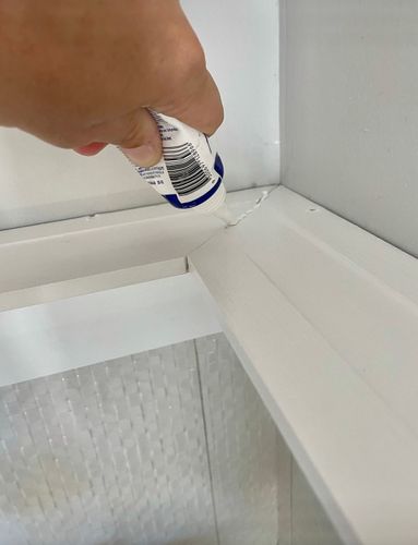

Lastly I used selleys no gaps to fill any gaps and to give it a clean finished look. 👌🏻
