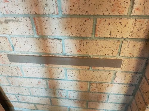

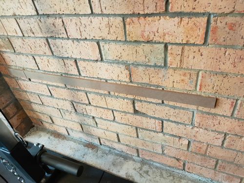

Hi Team of expert
Can anyone please advise how to stick the mirror on the brick wall?
What do i need to buy?
Thanks
Thierry
Selleys 310g Liquid Nails Mirror Metal And Glass Adhesive is the best product to use @Thierry. I'd suggest placing a dollop on each location where that previous wall material has still adhered. They look like they're well bound to the mirror's back. I'd then do a few additional squiggles over the rear of the actual glass panel.
Make sure you prop up the mirror until the glue has dried.
Do I need to remove the old glue?
You can try @Thierry, but given that it's ripped the previous surface off, I'd suggest that the glue be very hard to remove. If it's tough to budge, I'd just leave it there as you'll risk pulling the silvering off the back of the mirror and destroying it.

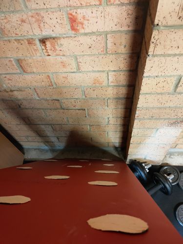

1. I used the suggested "Selleys 420g Liquid Nails Fast Grab Strong Adhesive" on a wooden prop, which i dont mind to leave it there permanently - see photo.
Hope they are strong enough to hold the mirrors.
The 3 mirrors each weights 7kg.
2. As suggested is it ok to use "Selleys 420g Liquid Nails Fast Grab Strong Adhesive" to glue to mirror against the brick wall, although the instruction says not suitable for mirror?

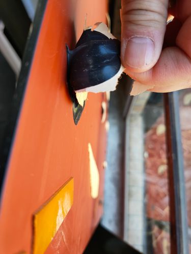

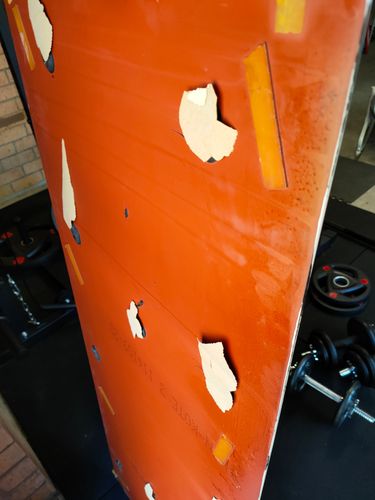

3. I removed the previous glue on 1 mirror (time consuming), but for the 2 others, can i leave the previous glue and put glue on the same spot? (See photo of previous glue)
4. Should i consider other sort of double tape instead of glue (might be messy and more difficult to remove in future) given that 1 mirror weights 7kg
Thanks Thierry
Great pickup there @Thierry! I sincerely apologise, do not use that adhesive. It might be fine, but don't risk it. The silver coating on the back of the mirror is susceptible to damage from adhesives, and the product I initially recommended could cause issues. You need to use Selleys 310g Liquid Nails Mirror Metal And Glass Adhesive, designed for mirrors.
You can leave the existing glue and apply the new over it. I'd advise using additional glue lines over the back of the mirror itself, though.
The glue and props should be enough to hold your mirrors in place. Double-sided tape doesn't work well at all on brick surfaces. If you are worried about the glue alone holding, perhaps use some Everhang 11kg Mirror Mounting Corners as well.
