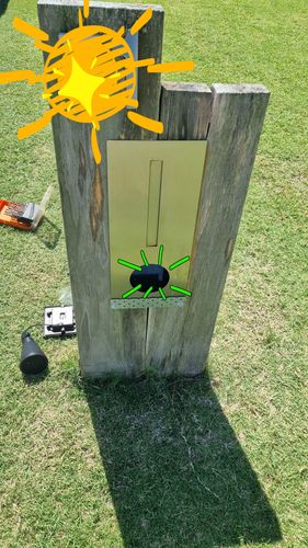

We bought this from Bunnings over 3 years ago and it didn't take long before it faded.Â
May I ask as to how to restore it? How do you properly stain/paint
this?Â
Thanks very much. 😊Â

Pressure wash it first, see if that brings any of the colour back. If you're not a fan of the colour after drying, either remove or cover the metal portions and determine if you want to stain or paint it and get the colour of your choice. I usually just apply stain the same way I apply outdoor paint on wooden objects (with a brush), I've used the Monarch 75mm Woodcare Paint Brush in the past for these things.Â
Hello @ErwinÂ
It's great that you've received excellent advice from @Remarka6le. The key to a good restoration is preparation. If the timber pieces are still in good condition using a pressure washer is a good option. Once the timber is dry, I suggest sanding the surface with an Orbital Sander to remove the splinters from the surface and give the wood a nice flat finish. If parts of the wood still have deep-seated mould, I suggest using 30 Seconds 1L Outdoor Cleaner SprayÂ
All that's left is to choose what kind of paint or stain you'll be using on the timber pieces. Just keep in mind that whether you choose to paint or stain, a yearly wash and a fresh coat will maintain the look of your letterbox.
