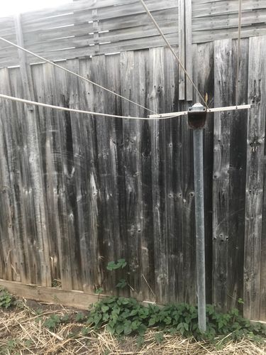

Hi. One of the lines on my Sunfresh retractable clothes line is slack. Can I tighten it in some way?
Thanks
Dan2sorry it's sideways!!

Thank you for sharing your question about how to tighten your Sunfresh 4 Line Retractable Clothesline. Sometimes retractable clotheslines have independent tensioning spindles. I suggest trying this method first. Pull the bar and engage it on the post at the other end. Leave the tension knob in the unlocked position. Pull down on each line to reset the tension on each line. Another method is to turn the tension knob into the locking position in quick succession. This sometimes engages the tension spring in the spindle to tighten up the lines.
If neither of these methods is effective your other choice is to manually adjust the line on the arm end. Look carefully at the bar and see if there is an access point. If there are none you will have to remove one of the plastic ends to gain access to the laundry line. Lock the tension knob in place and provide slack so that you can slide the laundry line out and reposition the staying knot on the line.
