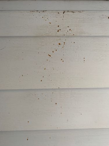

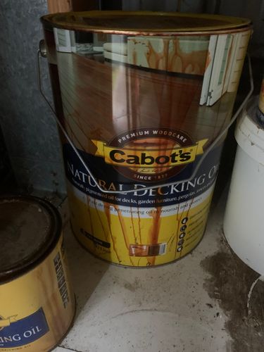

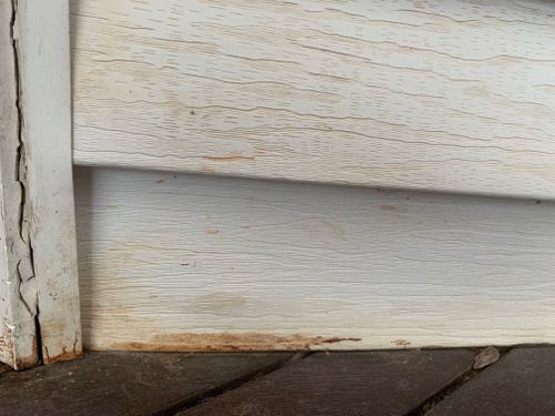

Hi Eric, sorry for the delay in responding. I have used a few different products to clean but haven't gone a harsh as Turps because i wasn't sure how that would go on Vinyl Weatherboards, more household cleansers. I have now attached a photo of the stain used and the stain marks on the vinyl weatherboards.

Hi @JulieN,
You could try some turps as it's the only thing I can think of that might shift the product. Unfortunately, the stain component has likely penetrated into the vinyl and won't come out. Do a test section to see if the turps affects the vinyl; I wouldn't have thought so. Painting might be your only option if you can't get the marks to budge.
