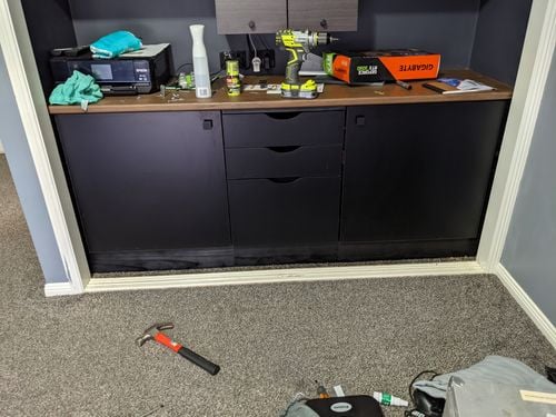

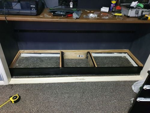

Step 1: I measured the interior and determined how high I wanted the bottom and middle shelves to be. I then built the office works drawer (I picked it up for $10 at time of purchase, I originally planned on building my own) to determine how much of the 120mm pine I needed to cut down, to my absolute amazement, it fit perfectly on top of the 120mm spray painted black pine. I then created the base for the drawers to sit on, the fronts for the bottom shelf and connected it all to the back 30mm pine that I was using to support the melamine in the future (these are drilled into either the studs or using wall mates).

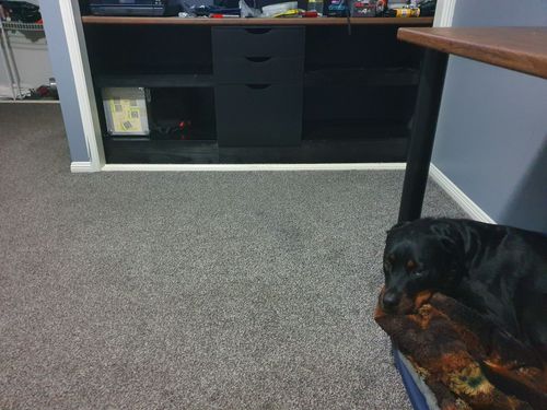

Step 2: Once the bottom was completly secure, I slid the drawers in for a nice snug fit. I secured it to the top bench using L brackets and used additional 30mm pine and attached it to the sides of the drawers and a new front to create the final lip that the melamine would rest on, this also helped the drawer into position. After ensuring everything was level (again), I cut the melamine to size and carefully placed the shelves in, which are flush to the front lip. These were then secured in place by either L brackets at the rear (for the bottom ones) and underneath the middle shelf inside the 30mm pine lip.

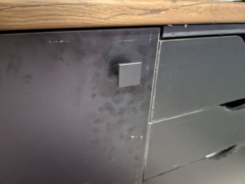

Step 3: I then had the issue of doors, which is something I learned I should have done first as the positioning created issues. I ended up cutting 2 melamine doors to size, used some edging tape to make it feel nice and used some spare 70x35mm pine to secure the doors onto, ensuring they were flush with where the drawers were. I then placed the two door handles I had purchased onto it so I could open the doors.

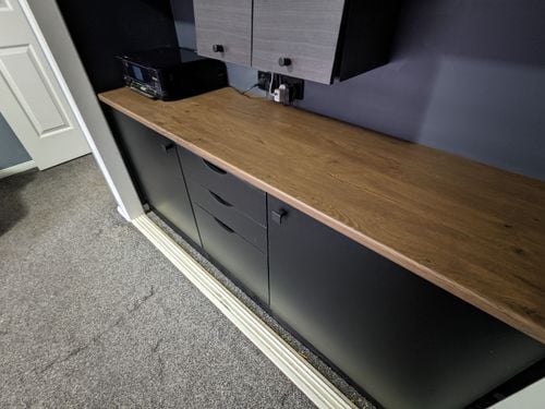

Final Thoughts
And that's that!
The drawers and storage did great for my work ability and my wives, and given the impending 2020 - current COVID crisis, the creation of this (and my home office as a whole - more to come) ensured I was ready for what is now close to 3 years of primary home based employment.
