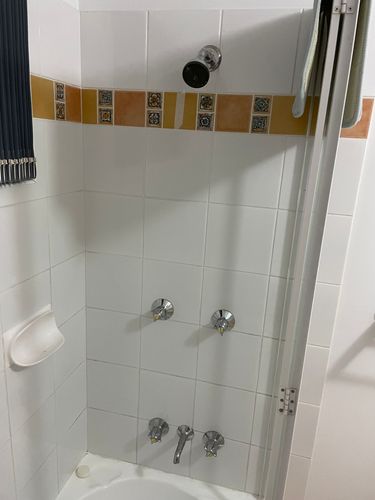

Please excuse my complete noviceness, I am completely new to this. With the pictured shower head, is that something I can install myself, aka do glue the rail, or do I require a plumber?

Ok so done, Unfortunately. I ended up calling the plumber to finalize the installation. For whatever reason, I was unable to get the drill bit to bite the tiles. The cooling system for the bit proved to be the worst part. If the water went into the sticky pad it would detach from the wall. After several more attempts and scratching the surface of the tile, I figured It was probably time to cut my losses and get the plumber to do it. Which he did for just under $150. He also added some silicon around the faucet mount to make it look nice and neat.
I will upload some before and after images.

Ok so here are the before and after pics
before
after
the head is not perfect, but is more functional that the previous. The shower is small, so sprays water everywhere if you have the hard middle jets enabled.
