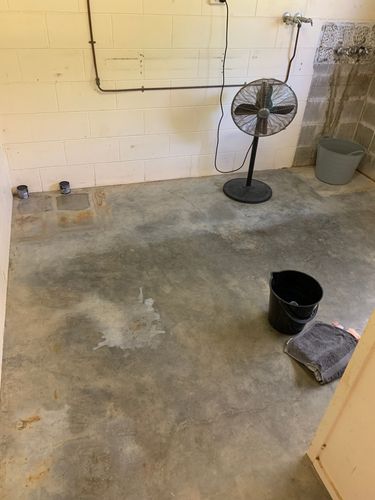

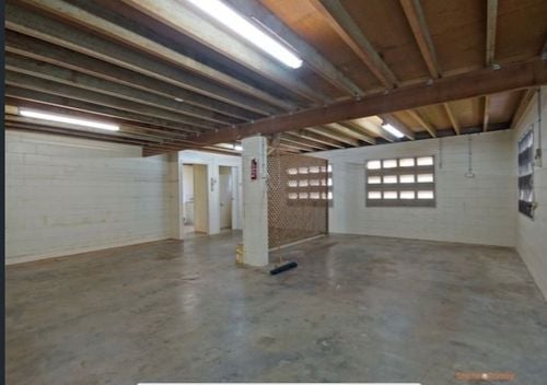

We are embarking on a big project of turning our downstairs space (enclosed but not sealed) into a full living space. The flooring is steel troweled concrete. It’s well done however has been used as a workshop by previous owners, so it’s grotty with a few dents here and there. We don’t think it’s been sealed.
first up is a small room off to the side which we are doing up the toilet and laundry, which means I have a small room to play with the floor.
What I’ve done:

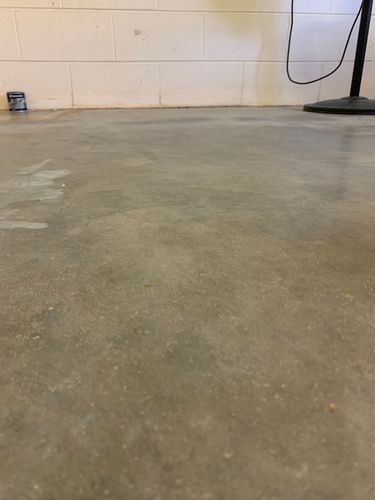

-stripped all glues etc from floor
-started an acid etch (but discovered another strip of glue)
-attempted to lift rust (mostly gone)
-test patch’s of floor sealer finishes (Cromellin DiamondCoat natural and satin, neither of which do I like)
What I’m planning:
-finish stripping sneaky glue
-give light sand with orbital sander (😬, not idea, I know, but it is just a small space and someone on the internet has done it with silica carbide disks, so why not try?!?!)
-finish acid wash
-sealing with Crommelin exposed aggregate finish tinted mid grey
Any tips, exclamations, directives? 😆
For the bigger main space we’ll hire a big sander but it’ll be nice to get an idea of the finish in this smaller room.
