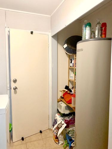

I want to overhaul my laundry, which includes getting some better storage in place. At the moment we have our hot water system right smack in the middle of the storage area. We *could* design storage around it, but one guy who is quoting on the job suggested relocating the hot water system outside (e.g. beside the house).
What pros and cons should I be aware of in doing this? I know they're pretty fragile beasts (internal glass and all that), and I'd never try to move it myself. Yes it would free up space, but it's not the end of the world having it there. Any advice? What's worked well and not so well for others? Cheers!
