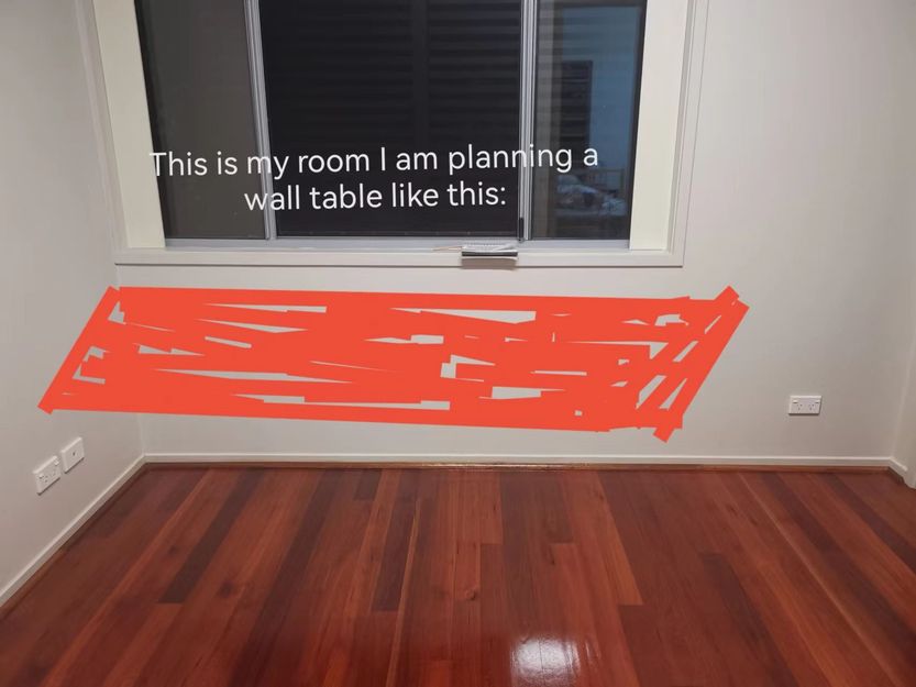

I am planning to build a Merbau panel desk under the window. Size:220cm*60cm. Please advise me how can I built it and what could I buy?

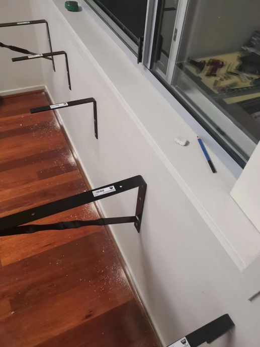

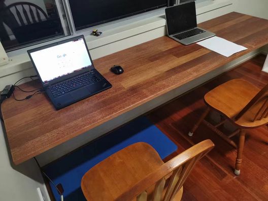

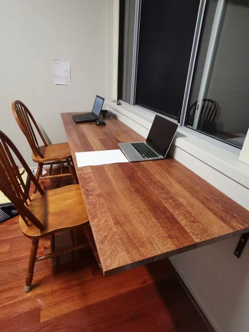

All done and looks cool. Yes, Angle brackets are more stable. So I used 4 Angle brackets instead of the Slotted Angle. The panel is 30kg. I am excited to upload some photos to you to share this and ask for your advice. It is really beautiful and easy to clean without legs. Do you think is this stable enough?
