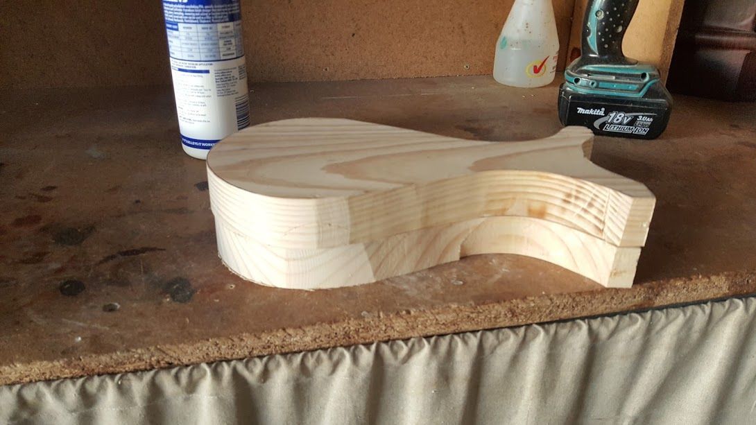

The headsets we have at home are fairly heavy, so I needed a chunky stand. Using a jigsaw I cut out two of the shapes, which I glued together for thickness.

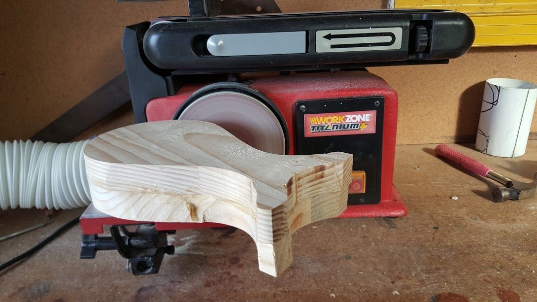

I am not very accurate with a jigsaw and my projects tend to cut at a slant. To resolve this issue I cut slightly outside the lines and used a bench sander to sand away the excess.

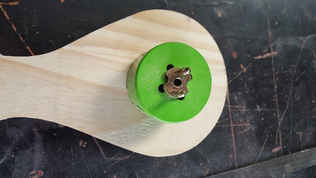

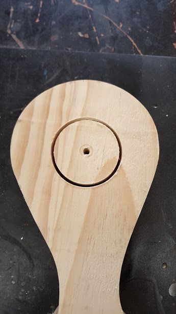

I marked out the centre and cut it out using a hole saw attached to a drill.
Hint: To get a nice, clean edge only saw half-way through then turn your project over and drill out the hole from the other side. This will prevent the wood from blowing out.
I smoothed out the inside using a sanding wheel attached to a drill.

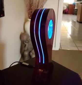

I have since made my husband another headphone stand with flashing LED lights.

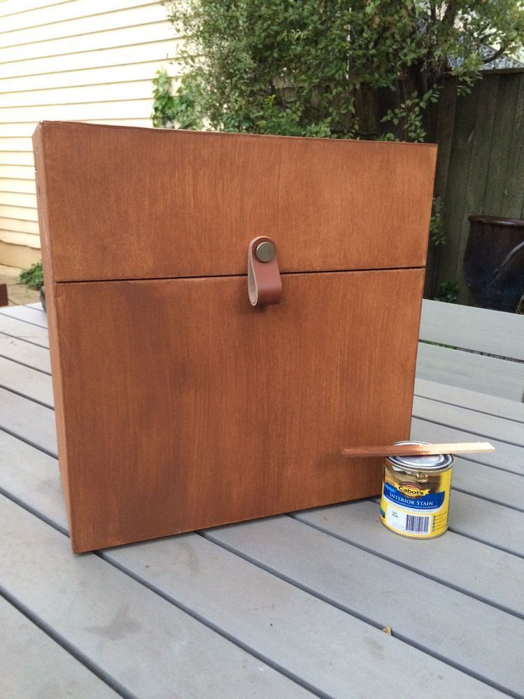

Bunnings Workshop member Dallas_Mc made this terrific vinyl record storage box with hinged lid.
