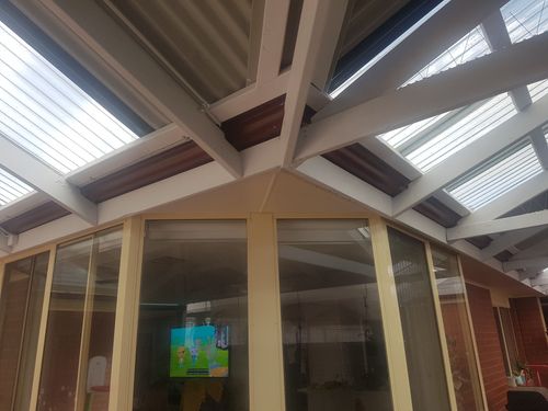

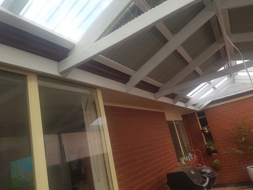

I'm looking for some advice on ways I can adjust my gutters to have them flowing again... in the particular section in the photos the water is standing and doesnt flow much at all, can anyone give me some advice on this??

Water will migrate to the lowest point possible. I'd suggest that the water is now trapped due to not having a consistent fall to the guttering. This could also be an indication of a structural issue in that corner. I can't think of many reasons why the gutter there would be sunken unless something structural was going on with the beams and the whole corner had dropped. It's a bit of a unique corner being chamfered off like that, and I suspect that might have something to do with this issue.

Please take a couple of photos while you're up there, as they'll help us try and identify any issues. How much standing water is in there? A few millimetres or centimetres?
Your roof design is a little complicated. You might be able to adjust the gutter's hanging brackets on that corner to raise it and re-establish the correct fall.
