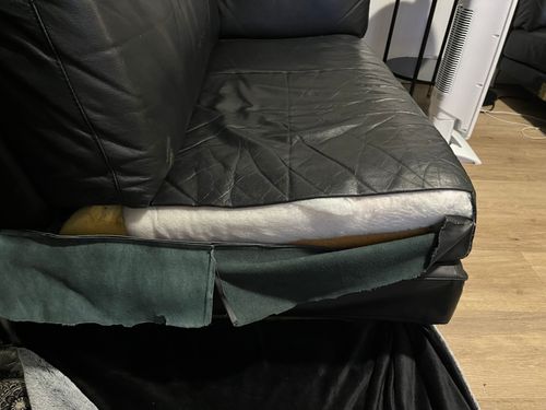

Typically something like that would need to be sewn for a professional finish @Bee73. However, if you fold that bottom section up and under the top, you should be able to glue the top down onto the lower section. Just be careful not to apply excessive amounts of glue as it will smear out onto the exposed leather surface, which won't look great.
Before you start the glueing process, the seam on the front of the cushion would benefit from a few stitches bringing it back up to the top.
