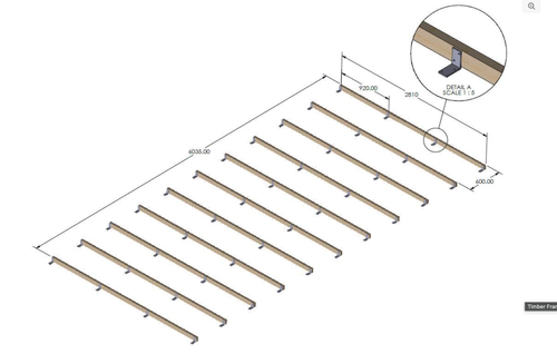

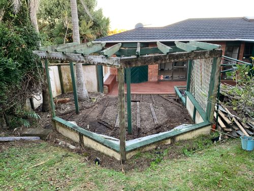

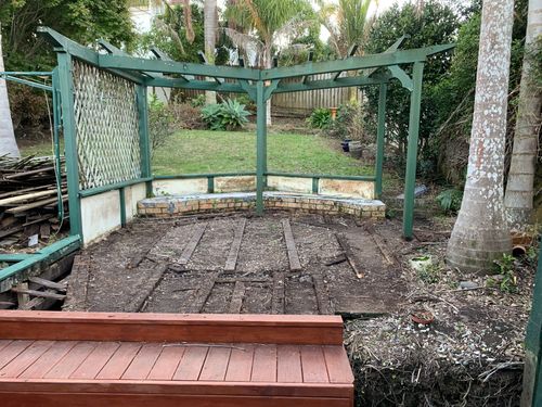

This is my first time building a deck. I'm planning to demolish the pergola and the bricks to build a low-level deck on a concrete slab. As you can see there's an unusable spa in the middle and filled with soil. I'm planning to use 90 x 45 treated Pine joists sitting on galvanised brackets with about 10mm ground clearance, I'll put a few H4 posts in the middle to support the frame.
Is it workable? would this cause air ventilation and drainage problems?
