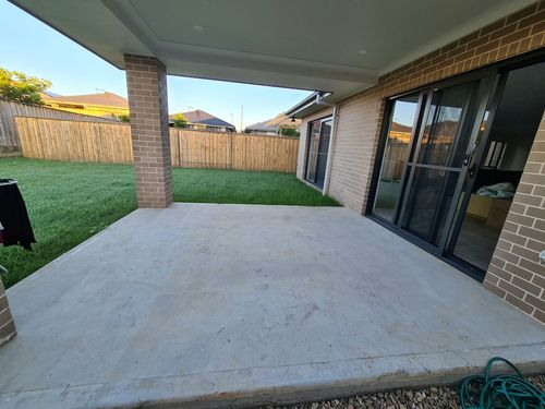

Hi there,
I have an alfresco that I wish to deck out. The alfresco is concreted with the house at the moment (refer attached pictures). Now I have compiled a list as below to take on this project but need advise from experts.
I have also gone through few DIY links before making a decision to go ahead :https://www.workshop.bunnings.com.au/t5/Featured-Projects/Low-level-deck-over-concrete/ta-p/77402
1. Bunnings Floor decking tiles
I am going with different approach (using Floor decking tiles) as my alfresco is almost the same level of mirror doors so i don't have to level up decking. Another reason for not using decking boards is due to lack of skill or might be extra cost than decking tiles.

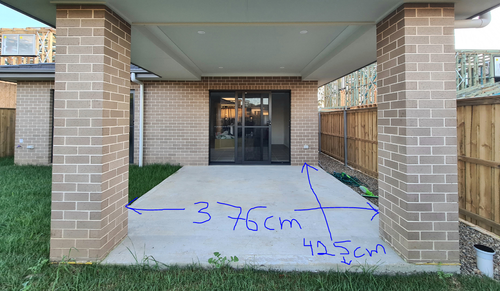

As per my calculation, i need to purchase = +177 (<200) blocks to implement this but not sure how floor decks can stay over concrete. Am i missing some additional steps or materials to avoid risk in my first DIY project?
Not able to find below floor deckings pack in Bunnings
