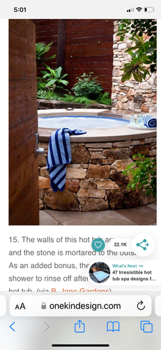

Hi all,
I want to build something like this for around my inflatable spa.
I have a very small area and need it to be as easy as possible.
all suggestions welcomed.
Thank you

Since we want the surround to be safe and not topple over, I recommend building a timber frame around your spa with marine plywood going over the frame. You can then attach the pavers to that frame so that there is no risk of the spa walls falling down. I suggest using Brighton Masonry 200 x 100 x 50mm Sand Mypave Paver. Simply join them together and to the wall frame by using Selleys 415g Liquid Nails Landscape Stone Concrete Adhesive.
Another option is to use Decor8 Tiles 300 x 300 x 10mm Beige Java Marble Tile Mosaic. But this time you'll need to use Dunlop 1L Multipurpose Water Based Primer to prepare the surface of the marine plywood. I then suggest using Davco 20kg SMP Evo Tile Adhesive to attach the Marble Mosaic to the spa frame walls. Please keep in mind that you'll need to grout the outside so that you'll not see the marine ply frame underneath.

Hi @Amanda1974 , sounds like a great project! Nice warm spa for cool winter relaxation 🙂@EricL is spot-on with all suggestions. Needs to be sturdy and any material must be fully-weatherproof or preferably marine grade. This includes any screws or bolts. Stainless steel will likley be best for them.Just one caution that's often forgotten about with inflatable type pools and spas. If the water is deeper than around 300mm then it is subject to the same rules as a swimming pool and needs to be appropriately fenced.

Creating a timber frame out of 90 x 35mm h3 treated Pine should be a reasonably straightforward task. I'd recommend cladding it with cement sheeting rather than a marine ply. Marine ply is water-resistant but can degrade if it doesn't dry out again. I'd imagine there will be a fair bit of water getting trapped in this structure, so I believe a cement-based product would be preferable. Another alternative would be to create the structure out of AAC blocks.
I've created a rendering below of a timber structure you could build.
