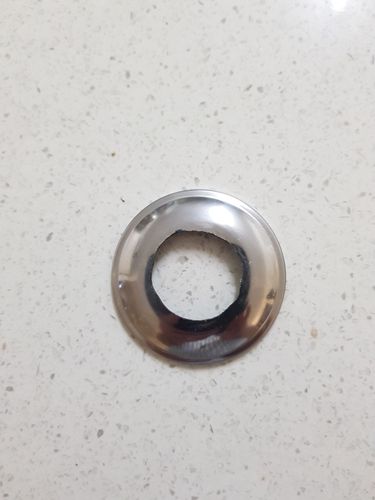

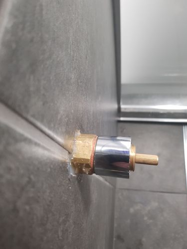

I've bought some new taps for our shower. The spindles were too short so I bought some ceramic disk spindle extenders. It doesn't leak but I'm stumped as how these flanges are supposed to fit.

At first glance, your first image shows what looks to be a well-fitted flange. Is the issue that you can't now attach the handle? Or, is it that the handle is now placed too far out from the wall?

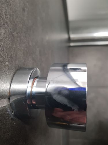

The photo is deceiving. There's a 2mm gap between the flange and the slide.
The taps are Mondella resonance with an enduraseal slide flange. The ceramic disk extenders are Brasshards 25mm. When I place the flange over the extenders and screw the slide on there's a 2mm gap between the two.
I also don't understand how the flange stays secure. It's not threaded and can freely move backwards.

Could you please indicate on your image where this 2mm gap is, as I'm finding it a little bit difficult to understand where the issue lies.
Have you attempted to install the handle and does that hold the flange in place? Typically, once the handle is locked onto the spindle end, the flange can't go anywhere as it's retained by it.

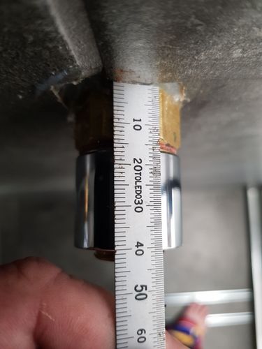

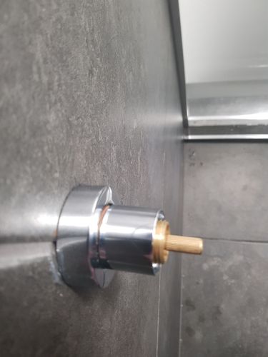

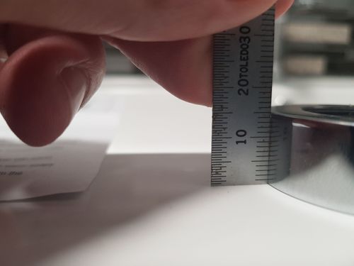

I've taken a few more photos. Hopefully this clarifies the problem a bit.
With these particular wall taps it has sleeve and a flange. The flange is a "slide flange". It has no thread. It has a rubber o ring and just slides back and forth along the sleeve. I assume it needs silicone against the wall when it's home to secure it but it's just not quite long enough.
Added some measurements to help explain the issue. I've contacted bunnings but can't figure out a solution that doesn't involve silicone against the wall and in the gap between the flange and the slide.
I suspect the extenders you've used have placed the spindle fractionally too far out from the wall for the sleeve and flange to cover it entirely. If the spindle was recessed further into the wall, I don't believe you'd be experiencing this issue.
What was the need for the spindle extenders in the first place? Was it the reverse of this issue where you couldn't get the tap handle on as the spindle was recessed too far into the wall?
Unfortunately, with wall spindles, you can run into issues where they can be challenging to install due to the depth at which you need to install them and the tile/wall lining thickness. The only solution I can think of would be finding a slightly shorter spindle extender. Anything 2mm shorter should work.

No spindle extenders are installed. Had to use ceramic disk extenders because the seats are recessed into the wall a fraction too deep for the supplied spindles and they wouldn't hit the seat. Can't seem to find anything shorter than the 25mm extenders already installed. Mondella list a flange extender but it doesn't look like they make one for this model. Thought about trouble domes but they'd need to have a depth of 18mm or so.... Apart from silicone against the wall and in the gap I'm at a loss...
I apologise, @Aneil. I used a generic term as the ceramic disc extender also extends the spindle further out from the wall, which is the issue here. The spindles are designed to be mounted further into the wall, which you cannot do. Due to pushing them further out with the disc extender, the flanges are not sitting correctly.

I was thinking more behind the flange rather than in front of it. The flange actually has an internal O-ring that seals against the body of the spindle. So I was thinking that we just need the flange to move forward so that it is on the body of the spindle cover. Have a look at the sketch below.
Thanks for all your help guys! I really do appreciate it!
My only concern is that the flange isn't secure. It's held in place by an o-ring that provides slight friction against the spindle body (sleeve - Mondella) and is easily moved forwards. Even with rubber behind the flange, the flange will still move forwards.
I don't understand how it's secured to the wall. It slides up and down the sleeve. Starting to think I've either installed these things backwards, or I'm missing something.
Just to put your mind at ease, you've installed it correctly and there are no missing parts. To my understanding, the flange only serves as a cover for incidental splashes from the shower. However, if you wish to seal it to the wall, I'm afraid your only choice is to silicone it to the wall and seal the gap between the body of the spindle cover.
