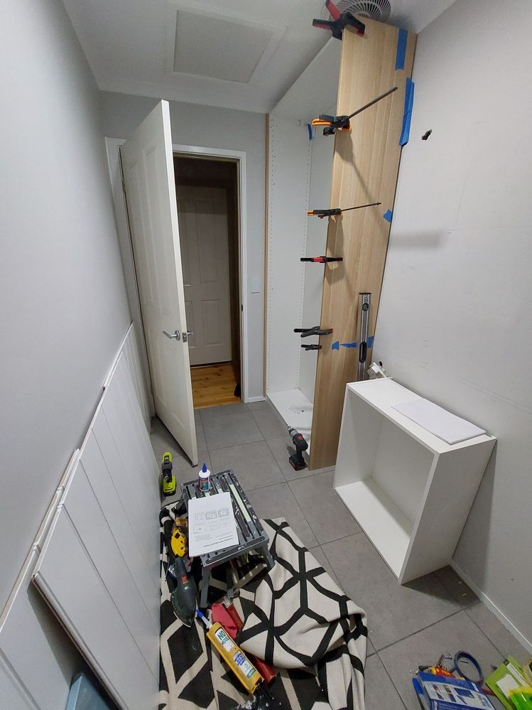

My first attempt at a big d.i.y project, laundry was full of mould. Basically gutted and started again.
Bunnings mdf colourboard was used for cabniets and is holding up well after 6 months of use.

The panel is 16mm melamine (natural wood), although i think the (Drift wood) may have worked well too
Being a skinny laundry room, it was difficult to find suitable pre made cupboards, I had to build the cupboards from scratch with plain white mdf boards
You are correct the table is laminate (its a stone effect colour that works well)
As far as history, the house was built in the 1980s and id say there have been a few hose leaks and it has got under the old tiles and original floorboards, I didn't realise this until i started getting into pulling the old tiles up, gave the old floor boards a good sand back and applied a water proof coat and cement sheet under the tiles so no issues going forward hopefully. Also applied plenty of caulking where the melamine touches the floor.
I will try add some pictures of the wall on the door side, i used the easycraft wall panels 600mm, I think they really spiced up the bare wall
The doors still have the safety film on them hence the darker blue, the light blue is the actual colour (High gloss light grey/blue)
The tiles are subway, with a ripple effect and light grey grout (Ash black was my second choice)
Walls are Taubman's "silver tea set", a new favourite colour of mine, tempted to use over the rest of the house
