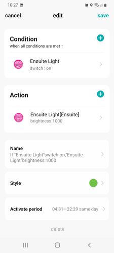

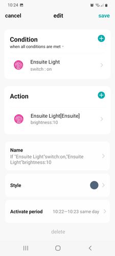

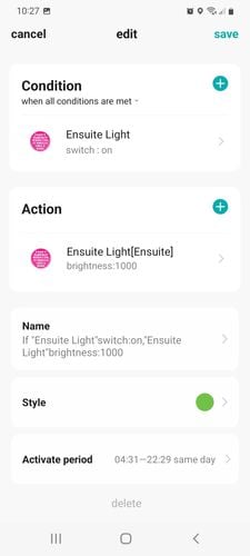

Just thought I would post a simple automation chain for setting a schedule to dim down the Arlec globes a set times and days you require.
I work late nights on rotation and when I turn the ensuite light on I don't want to the light on full brightness waking up the better half and I don't also want to be fumbling for my phone to dim it down so I set the 2 following automations.
Someone might know how to combine them into 1 and that would be fantastic.

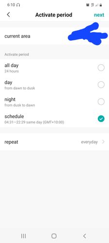

By setting your active period down the bottom you ate telling the automation when you want it active.
You can have the light switch flicked off and flick it on within that period and it will dim to lowest setting or whatever you have it set and it will remain in that state for that set period.
