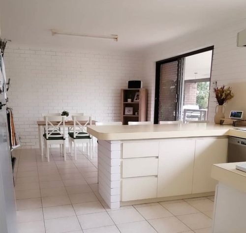

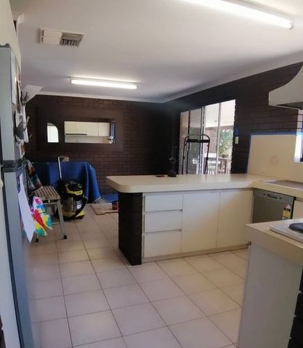

Have you considered painting the bricks white instead of white washing?
It would be a much easier process and create a uniform even finish.
We painted our brown interior brick and it turned out great!
Before:
After:
Cheers,
Luke | @TheRenoDad
