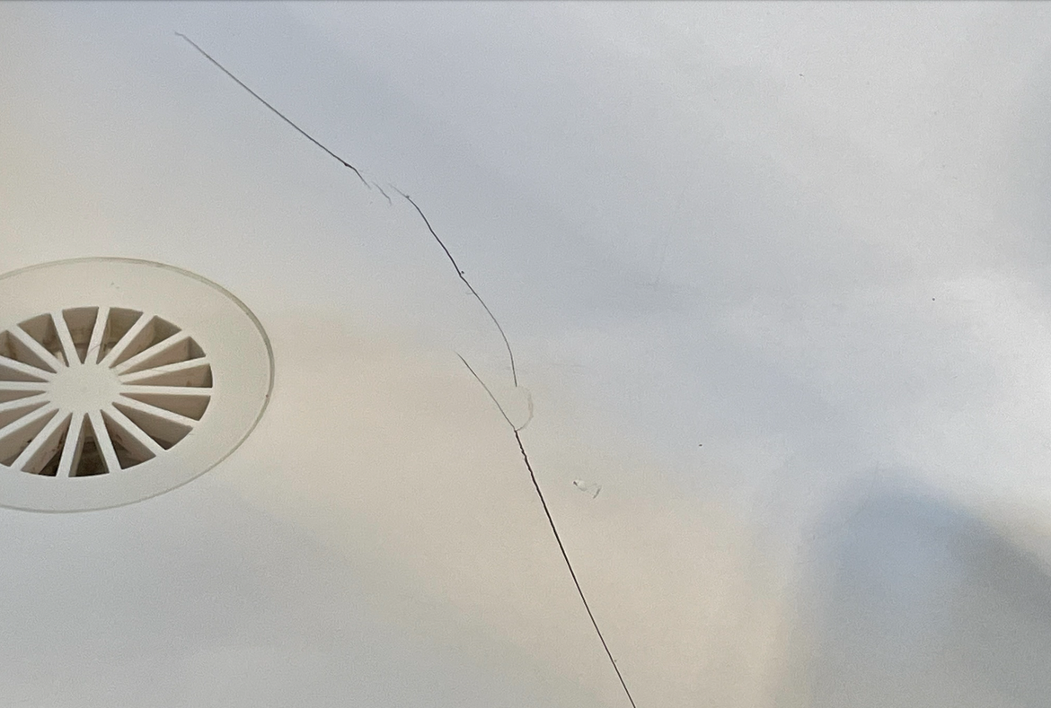

Recently we found the shower base cracked, we want to know how repair or replace it.

Unfortunately, when the crack is this extensive it will need to be replaced. I suggest measuring the size of your current tray and checking out the available trays at the store. I also recommend getting some bathroom repair quotes for the removal and re-installation of the shower assembly.
But while you are waiting for your repair quotes, I suggest using Selleys 100g Translucent Ezi Press Roof and Gutter Silicone Sealant. You will have to use a Pro Renovator 38mm Plastic Scraper to create a low-level patch over the crack. Make sure to push the silicone into the crack so that it is completely sealed. Please be aware that this is a temporary repair measure, and this repair will not last very long. I recommend replacing the tray as soon as possible.
Please make sure to give the silicone sealant enough time to cure and make sure that the area is well ventilated.
