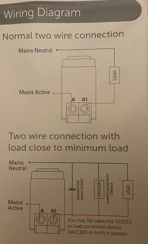

I'm looking to pickup up a whole lot of these DETA smart switches (https://www.bunnings.com.au/deta-smart-switch-mechanism_p0346912) as they don't need a neutral wire (and the old part of my house doesn't have one). The hallway has a 3 way switch (one switch at either end) and I'm looking to see if anyone knows if these switches are compatible? I know other Grid Connect switches don't support 3 way switching.
The flickering issue is real and annoying.... however I've gotten around it by using one Grid Connect candle globe in the 5 globe chandelier. The WIFI component of the globe must be enough to stop the LED flicker.
