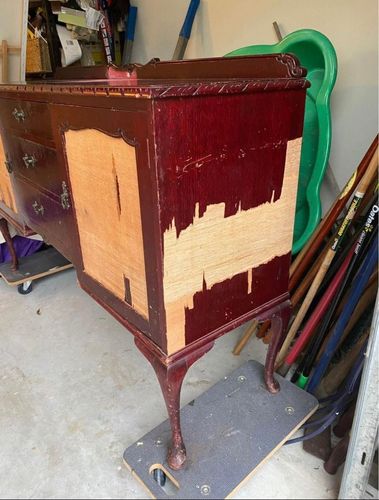

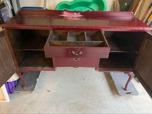

This c1940’s sideboard was in desperate need of a renovation. It was so damaged and worn, with the veneer peeling off in parts.

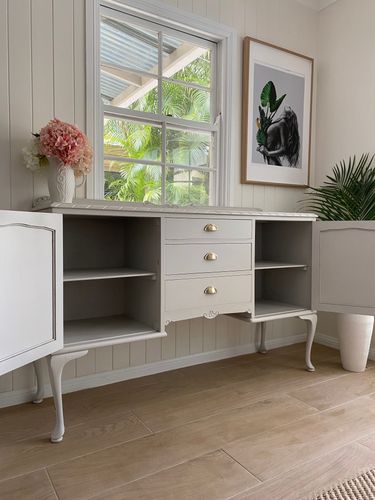

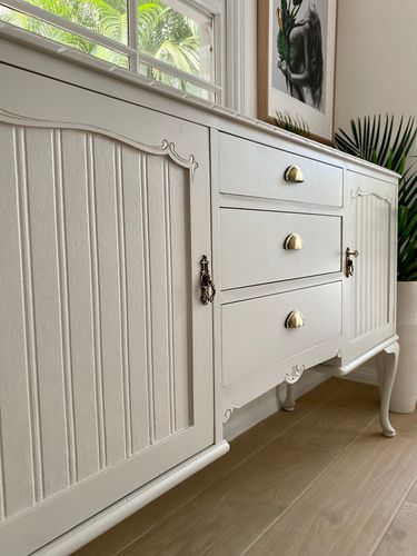

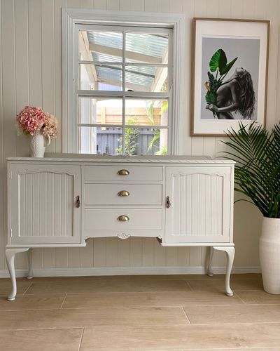

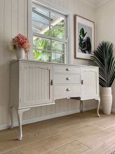

I stripped it all back taking all the old veneer off the doors and sides. Sanded it back, replaced the sides and doors with paintable wallpaper from Bunnings, undercoated it with BIN Shellac based primer, then Sprayed 4 Coats of Dulux Water Based Enamel through my Wagner Spray Gun for a flawless finish. Restored the original drop handles and replaced the cup ones. I’m very pleased with the result and it has sold already! For more inspiration and more pieces like this please follow Emily Alcock Projects on Instagram
