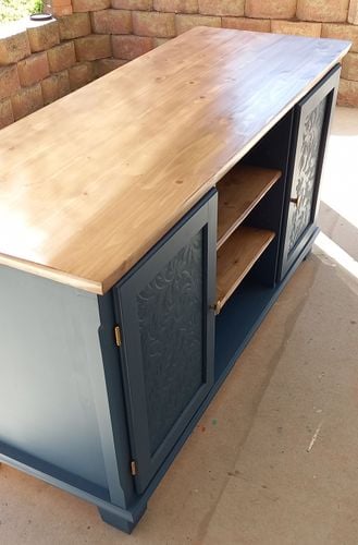

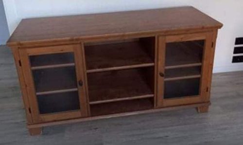

I saw the good bones of the piece for sale on marketplace and the beautiful timber hidden under an awful orange stain. The first step was to remove the glass panels from the doors, cut ply to the same size and glue on paintable wall paper, which was then inserted back into the doors.

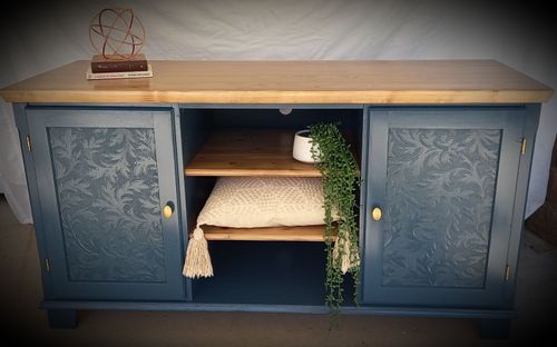

I used 60, 80, 120, 180 and 240 grit on an orbital sander to strip the top and shelves to expose the stunning grain. This was followed by 2 coats of a stain mix of Cabot's Brazilian Roast and Cabothane Clear. An additional coat of Cabothane Clear was added to the top of the unit and topside of the shelves for durability.
The remainder of the piece was primed using BINS primer, 2 coats of Dulux Surf'n'Dive and 3 coats of Cabot's Cabothane clear.
This piece is one of my favourite pieces
