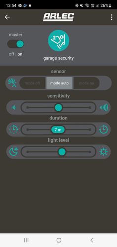

I want to check the status of a security light I.e is it in on/off/auto. Currently when using in condition check for automation I only get normal and error which means I can't combine it with sensors else where.

I am using "Arlec 20W Grid Connect Smart Security Light With Movement Activated Sensor" and "Arlec Grid Connect Smart Home Sensor Kit" along with grid connect software. I am trying to combine and make them work together ie extend the range using more motion sensors. If I set the security light to on manully through the app not auto I want it to stay on without other sensors causing it to time off. I know there is a conditional check when setting up automated tasks but it will not give me the mode of the security light so I can't conditionally combine them. Other solutions motioned in posts have access to modes on or off, the security light does not expose the mode it is in
Arlec 20W Grid Connect Smart Security Light With Movement Activated Sensor do no expose events about sensor so cannot trigger any automated tasks. Cannot even read current sensor status to be combined with other conditions making it useless to extend its capabilities with other devices.
There is a free PIR sensor on board why can't it be used or combined to make complex tasks

Spoke to Arlec Australia and this is not supported which is not very good. Only option I have figured out is to add another sensor and use that to control a group of security lights switching between modes.

No not really as the security lights sensor does not expose any events to watch except error status which is no good. Automation can be done using another sensor standalone which could trigger a scene that does work but when setting up complex combinations this does not work as I can tell state of security light. 🤔 hope that helps
@barrywilson you should see the sensor position change on the front screen but I will check tomorrow, even if you don't you should still be able to write the flow of automated commands to trigger other sensors. I am about to install a second PIR onto this one circuit and will be joining them electrically and by software.

Cool thanks, that's what I have done. I also have a trigger to turn all security lights to on when I want. To prevent my sensor from resetting this I added a standard light close by where I can check its status. I use an all conditions check, if it is on to not run this routine. Bit of a hack but seems to work. Hope that is useful.
