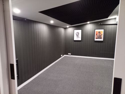

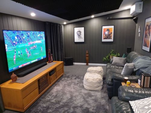

The kids moved out so it was time to reclaim the family room as our space and with a bit of imagination and research I think we did a great job

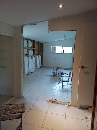

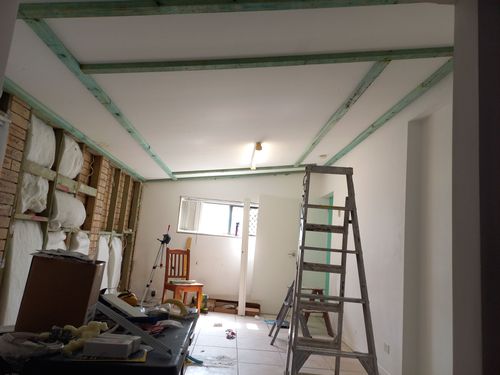

Hi Eric thankyou for the positive feedback .We had quite a bit of damage to plaster walls from storm damage so after roof was repaired I set about removing all wall plaster and replacing with axxon cement sheets .then I did a false ceiling with studs to create a centre area for foam accoustic panels .before plastering the drop ceiling we ran lighting cable for led smart lights which came up fantastic. I installed double slider doors on entry .I ended up using the 1 MTR carpet squares I saw at Bunnings on floor and they worked out perfect over tiles and saved me over $1200 on carpet layers. Porters paint flat on walls .yes we had first movie night last weekend . thankyou for your interest .
