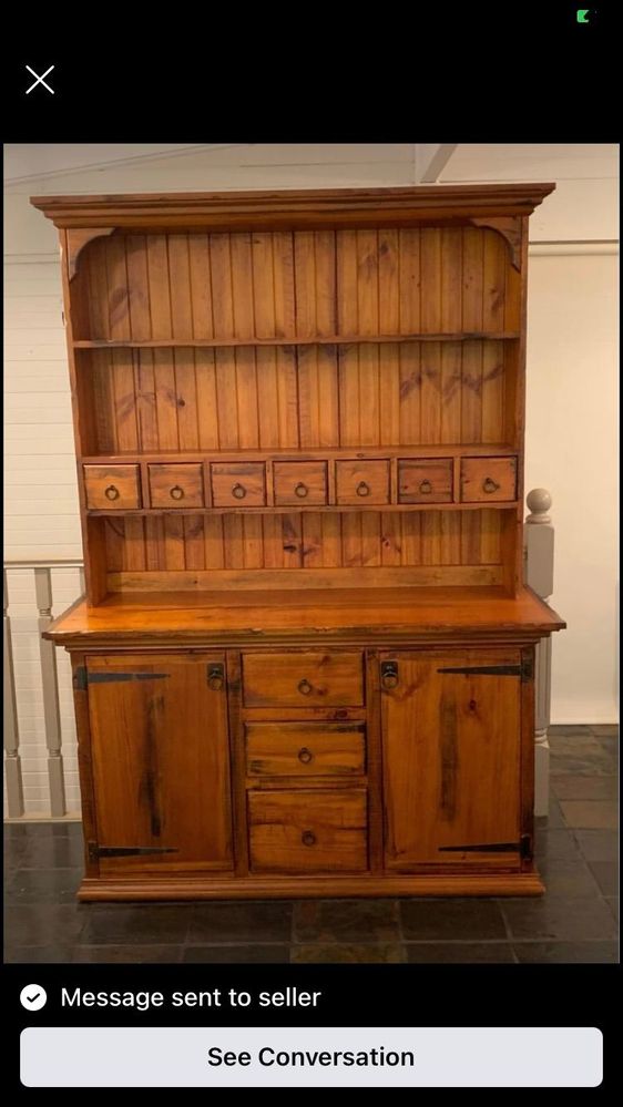

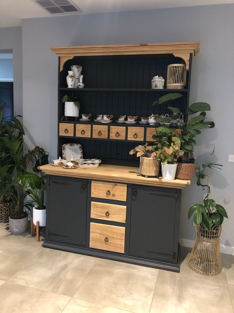

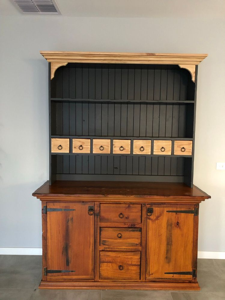

Upcycled a Kitchen Hutch that I bought super cheap off market place. Sanded back the top of hutch, the bottom and the draws. Used the Ryobi one plus belt sander for the top of the hutch. I then used the Ryobi one plus cat sander for everything else. To start 80g paper, then 120g, then finished with a 240g for a super smooth finish.
Painted with Porters Aqua trim in Riverstone. Used Feats Watson Matt clear for the lighter timber.

Hi, thanks for your kind words. I definitely removed the top and worked on each part separately. I made it easier to sand when they were apart.
The best way to get such a smooth finish is to always use a good quality brush. I used the Monarch doors and trim brush in the 50mm, which is a smooth and soft brush. The better quality the brush the better the finish. I’m by no means an expert painter. The Porters paint is an excellent quality paint also. When doing any finishes I always use a good quality brush and a good quality paint. Other great paints are Taubmens and Dulux depending on your project.
