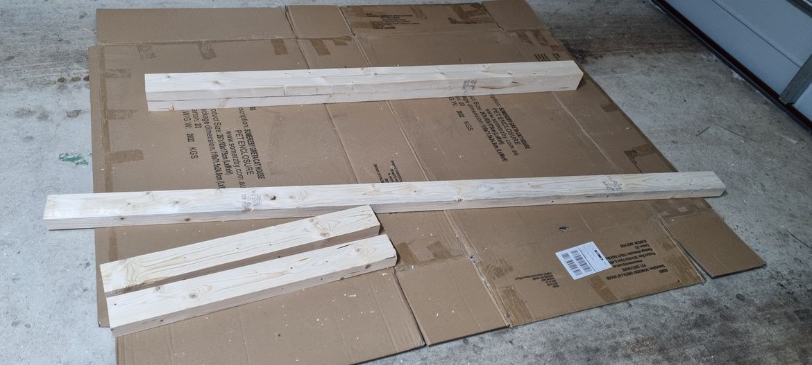

I first cut all of the sides to slightly longer than the final lengths
Bed sides Lumber cut to length

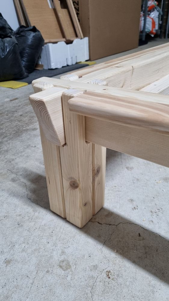

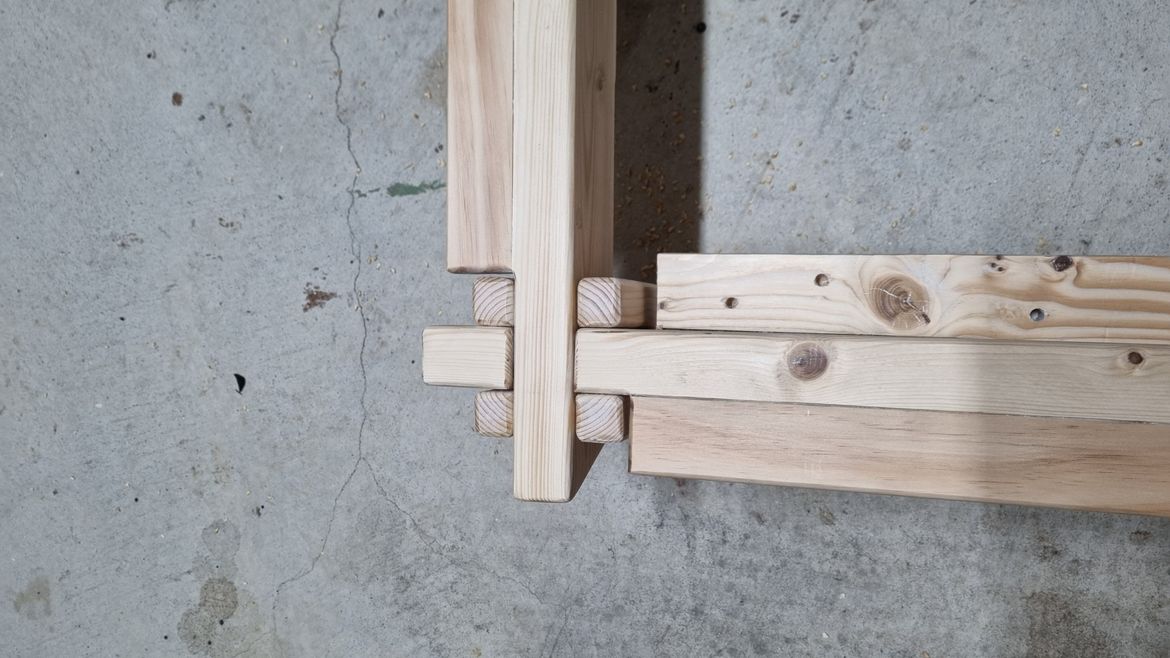

The legs were made by gluing together two pieces of 90x45mm pieces. I then cut the slots into the legs and the sides using a hand saw and circular saw to create the castle joints. Of course the cuts were not perfect and they had to be cleaned using a chisel and lots of filing and sanding.

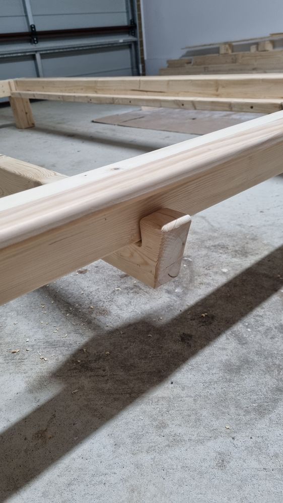

To create a platform effect, I glued and screwed 42x19mm DAR pine to the outer side flush with the top. I had to plane the side of the 90x35mm that was on top to remove the rounded edges that are typical of construction lumber. This ensured that there wasn't a gap between the side and the platform edge.
Castle Joint

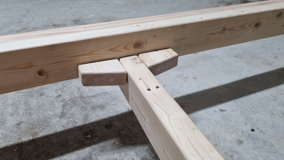

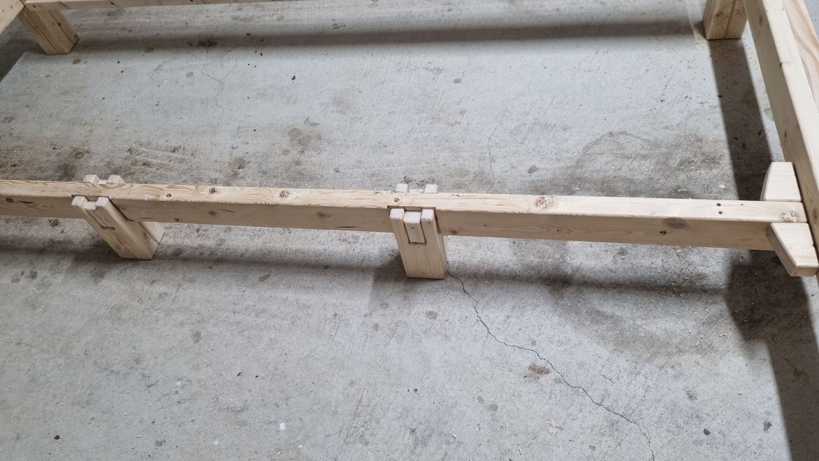

Since I was using castle joints on the outer legs, I cut the legs on the middle support to also have castle joints. I also cut slots into the middle support to mate with the front and back sides of the bed frame and added supports on the inside to prevent the middle support from moving side-to-side
MIddle support
Stops besides middle support to prevent it from moving side to side
All of the vertical sides were cut to the final length at an angle and I ran a router with a round-over bit to smooth all edges. I also added a groove running along the middle of each side of the leg to hide the seam created by joining two 90x45 pieces.
Castle joint from the side

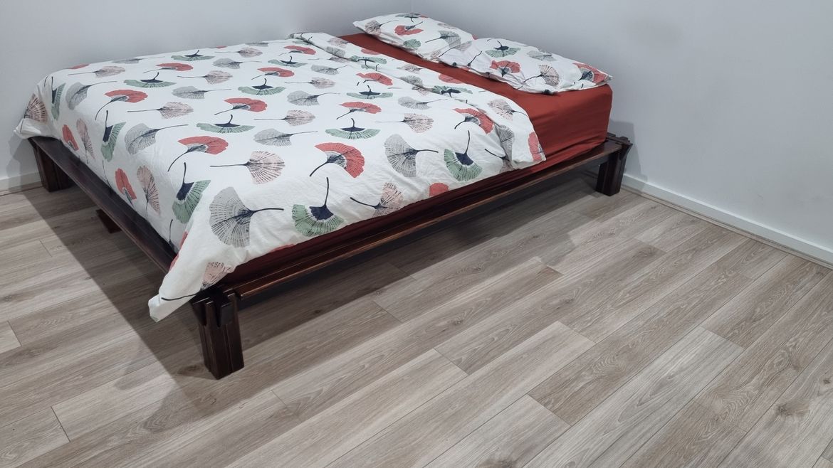

It was now time for final assembly
and enjoy the new bed
All done
