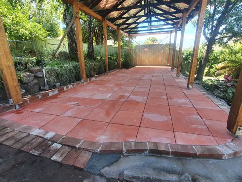

Decided we needed more room so I created an outdoor space for the family to enjoy alot of digging, shovelling and carrying in material but was all worth it.

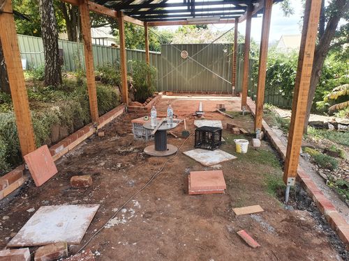

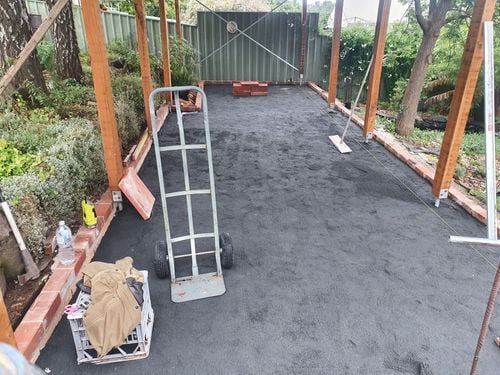

once brick edge was in I spread 50 mm of crusher grit and compacted with a bit of 20 mm plate welded to a handle, was an effort but I got the job done

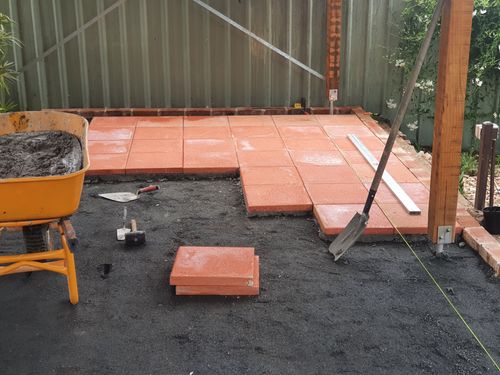

laying pavers in a crusher grit and cement mix should help stop any weeds coming up also prevent any pavers sinking over time

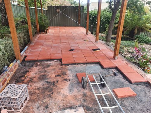

once you get the first row in and a square line to work off its easy going

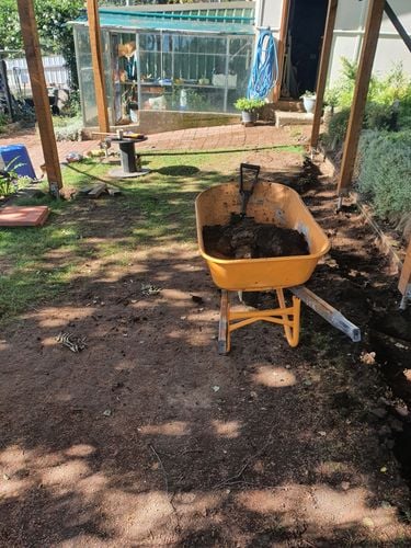

spent a day digging out area to level out as much as possible ready for a brick edge and a solid crusher grit base
