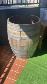

I’ve purchased an old wine barrel and transformed into the table.

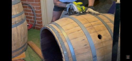

The first step was sanding the whole barrel to bring back the good oak, I used a belt sander and a 120 grit sand paper that o got at Bunnings. Then I secured cut the barrel in a half using a circular saw.

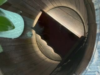

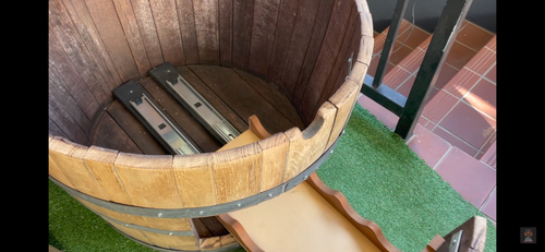

I wasn’t happy in only putting a glass top on it because could be nicer, so that’s when I decided to use some drawer slides on the bottom and open a small side door where I’d install a drawer with a wine rack.
For the drawer I’ve used 2 Goliath heavy duty drawer slides and a piece of metal and a wooden wine rack, all from Bunnings.

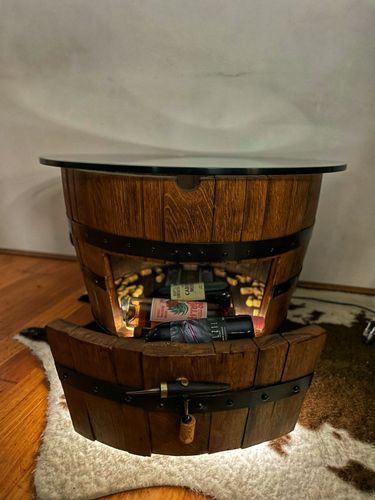

For the finishing I used a Walnut colour wooden stain and a interior satin varnish Cabots.
The last part was just setting the round glass on top and enjoy my table.
