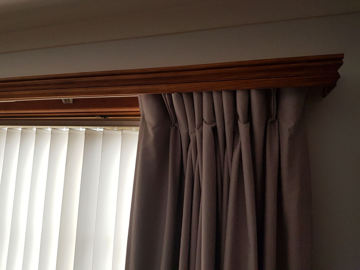

PHOTO 2

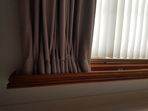

PHOTO 4

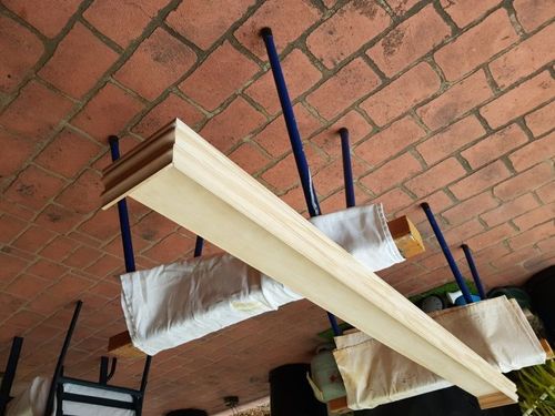

Photo 1 a finished box pelmet

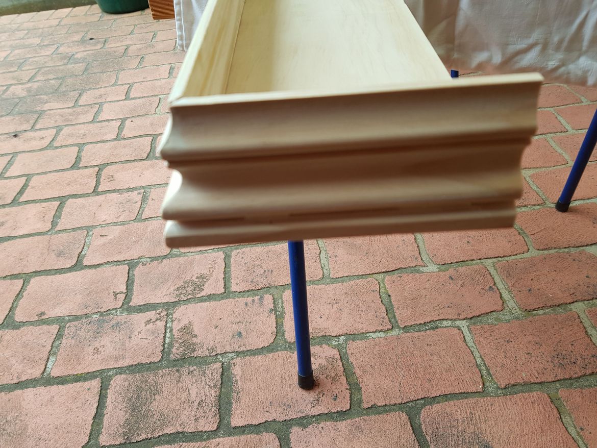

The materials used are milled pine for the tops of the pelmets, the sides are also pine wood, in this case moulded to blend into other furniture.
Photo 2 , corner detail showing the small amount of putty required.
The mitred corners were cut using a drop saw to ensure a 45degree angle.
A note on my personal experience here, wood of all kinds is of course a natural product and will warp. The degree may vary from non-existent to extreme, avoid extreme. I found that even with precise measurements of the elements of my pelmets (top and three sides, the pelmets are designed for wrap around curtains). There came a point at which some putty was required. There are many types of this product available, I found one that matches the colour of the pine wood.

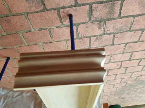

The box pelmets were finished with Sikkens (again to match existing window furniture)

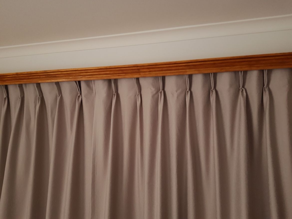

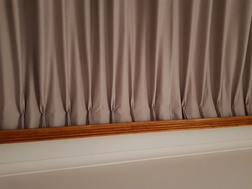

Photo 3, box pelmet covering the insulating block out curtains.
Photo 4 revealing the wrap around effect.
