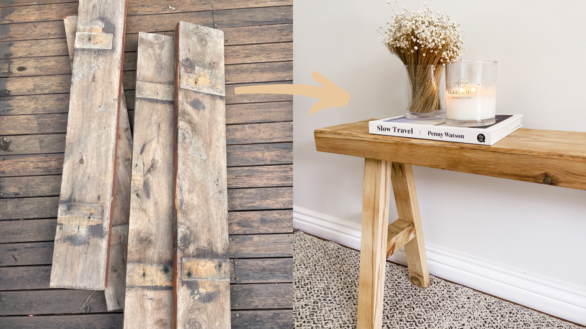

I made this using salvaged timber from an old table top we found on the junk pile. One board made the bench top and another board ripped into lengths made the legs.

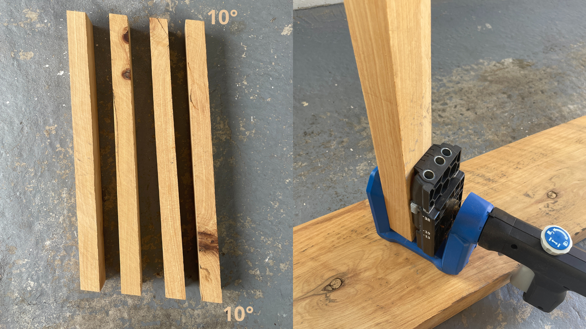

Using the mitre saw cut 4 legs at a 10° matching angle on both ends. My legs are 450mm long.

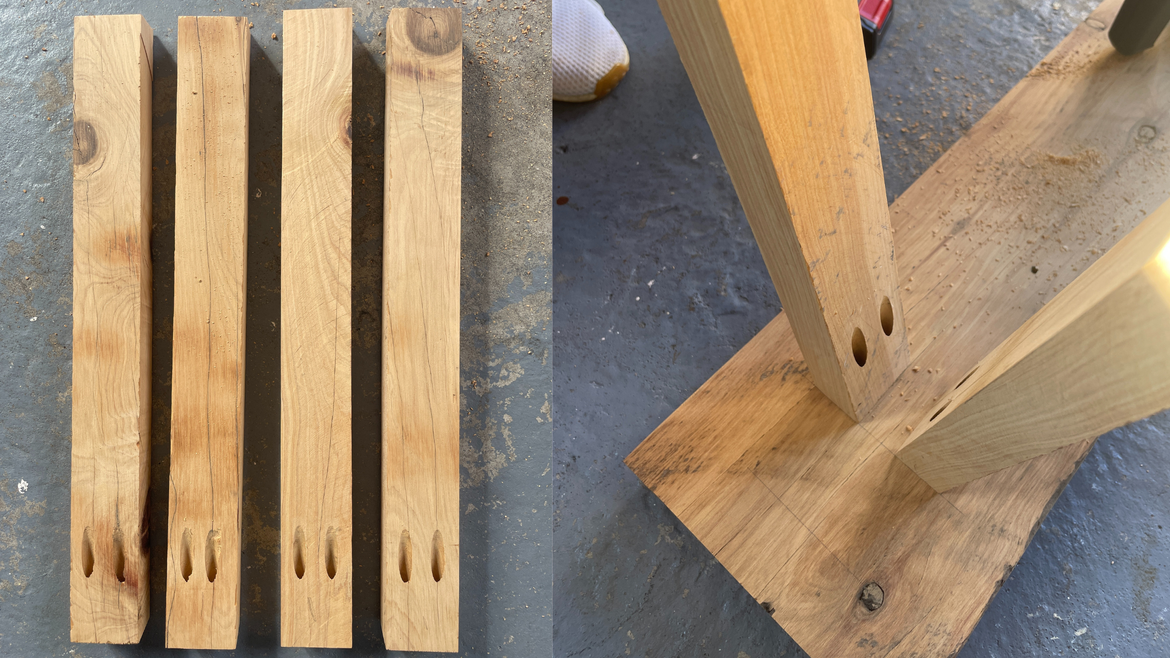

Use the pocket hole jig and bit to drill two holes into each leg. Make sure you drill the holes into what will be the back side, or inward facing side of the board.
STEP 3
Decide where you want the legs to attach to the top. We came in the width of 2 boards from the end (100mm) and the width of 1 board from the edge (50mm).
STEP 4
Attach the legs to the underside of the bench top using 2 ½ inch pocket hole screws.

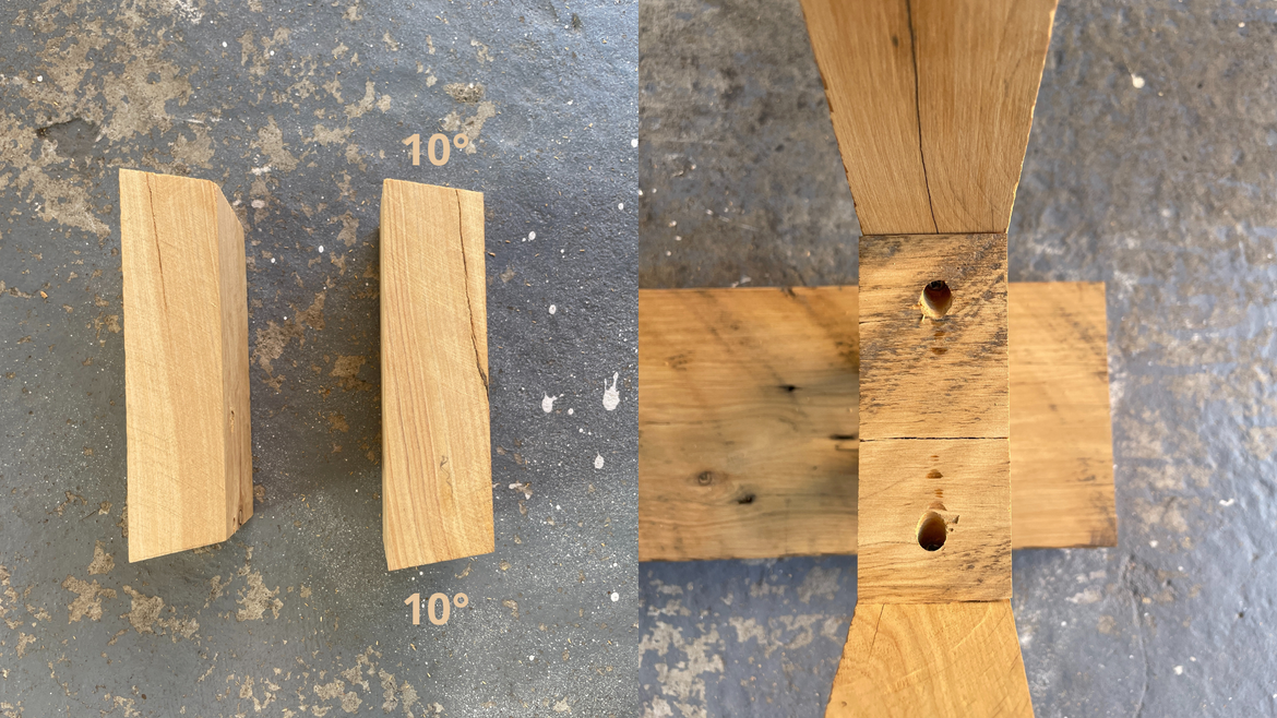

Decide where you would like your leg supports to sit, and holding the support up to the legs mark the 10° angle cuts on both ends. Make the cuts using your mitre saw.
STEP 6
Drill pilot holes through each end of the support at roughly a 45° angle then attach to the legs using 1 ½ inch pocket hole screws (or suitable wood screws).
