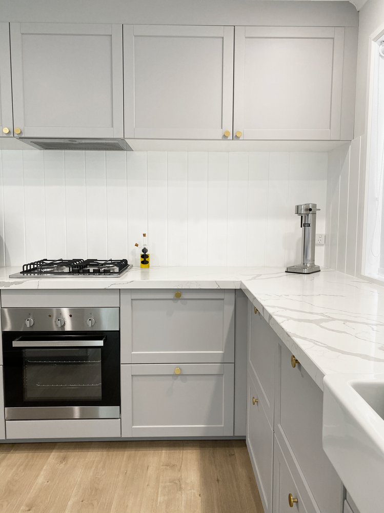

We used James Hardie Axon Cladding to create a vertical panelled-look to complement the shaker style cabinetry.
We wrapped the Axon Cladding around the walls of the kitchen and capped the end panel behind the coffee station with a White Aluminium Tile Trim.

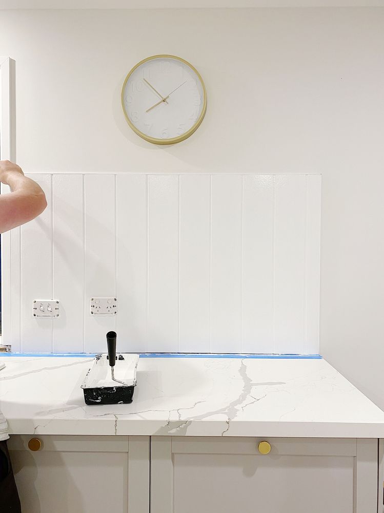

The cladding required around 5 coats (yes, 5!) of Taubmans Professional White Gloss Water Based Enamel Paint.
We painted the panelled grooves and edges wish a brush and used a foam roller to roll on the enamel paint. The foam roller helps to create a smoother finish and avoids leaving any brush stroke marks.

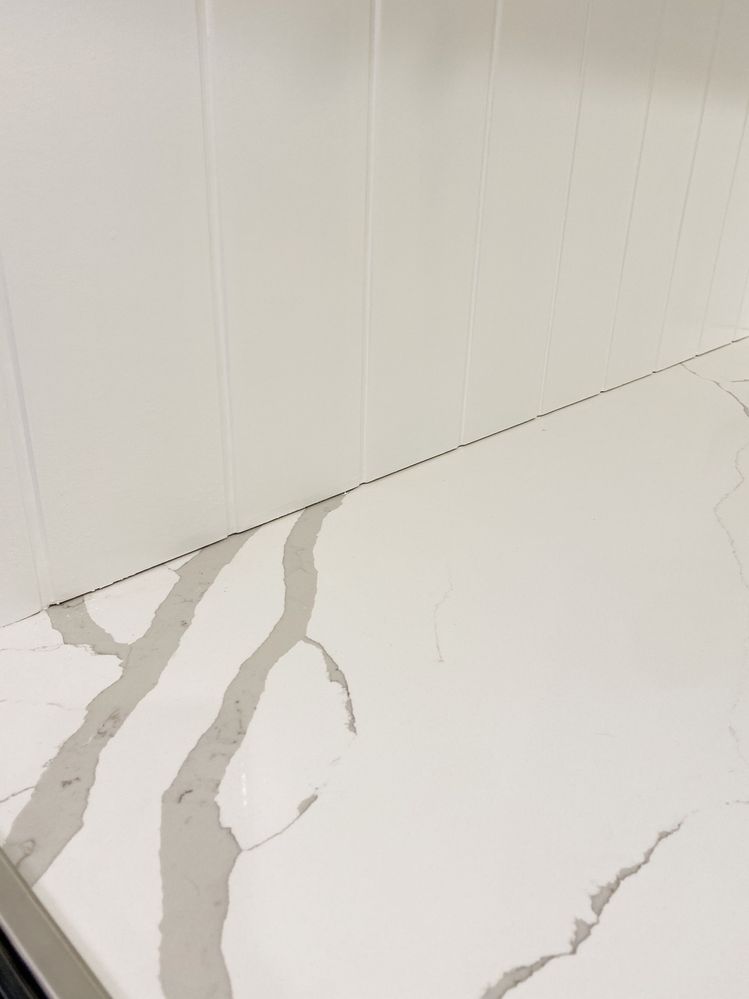

We then siliconed all the edges that meet the top cabinets and benchtop using Selleys Wet Area Waterproof Silicone Sealant.

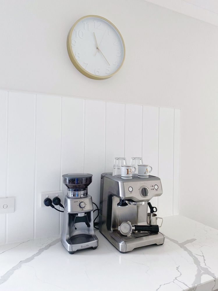

Food splatters, oil and liquids wipe straight off the enamel surface and after 9 months of use, the splashback is still as white and clean as the day we finished this DIY project!
Painting the backsplash in Taubmans Professional White Gloss Water Based Enamel Paint

Finished backsplash behind the coffee station
