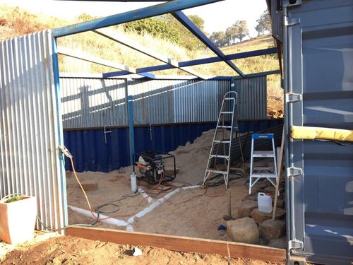

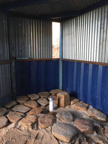

Started to cart in the rocks and place in a crusher grit base while trying to keep it flat

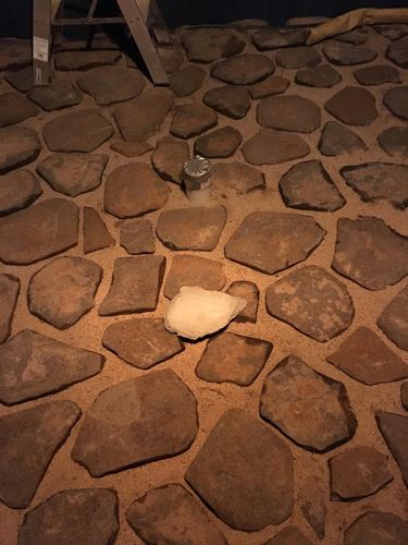

all rocks in place and held there with crusher grit, it was then hosed in for a few days to help it settle

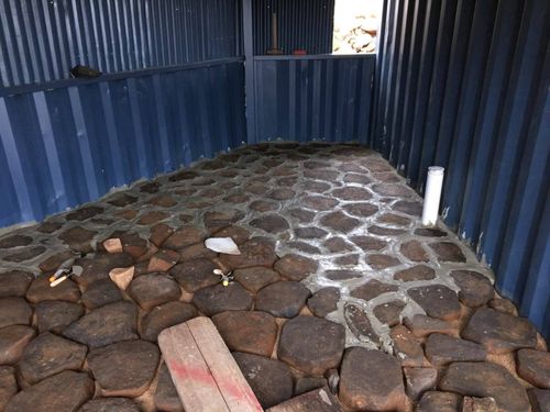

next step was to dig out some of the crusher grit down about 80mm ready for the motar grout

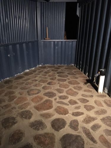

made a strong mortar grout using sand cement and bondcrete scooping it in and filling all the joints

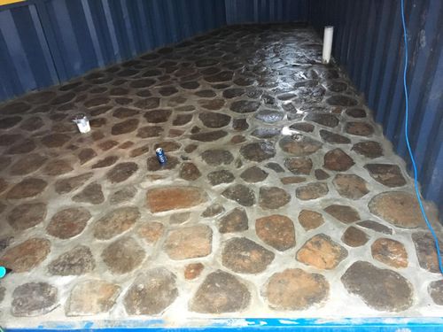

once it dried out enough we hand washed it to get excess motor off the rocks with a water and acid solution
