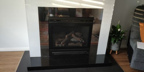

Renovated the fireplace from an old boring metal frame to a more traditional design. Extremely happy with the outcome.

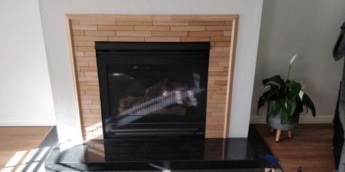

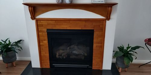

I didn't replace the metal frame. Instead I stuck pieces of wood cut into small pieces to give the look of bricks. The mantle shelf was made out of multiple compressed wood sheets and fitted onto the corbels. The corbels were purchased in a wood shop and fit onto the wall.
Finally I polished all the wood with the wood polish to give a darker shade to the whole thing. Took us(my wife and self) to figure out the best design with the limitations we had in terms of tools and the weight constraints.
