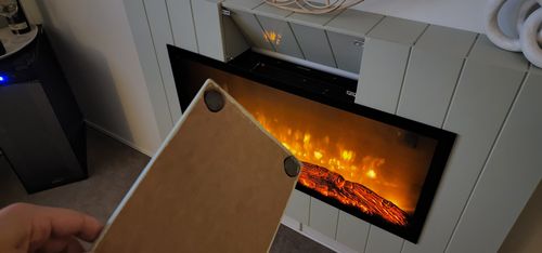

A little weekend project building a fireplace

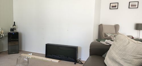

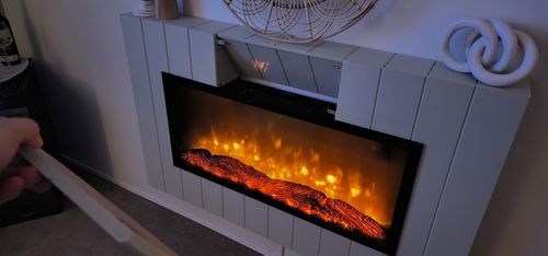

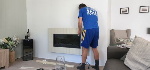

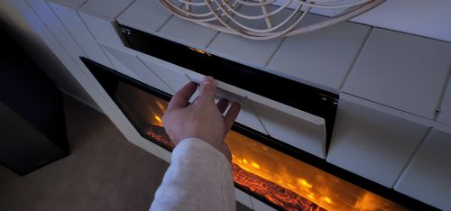

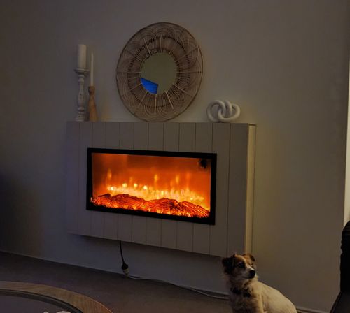

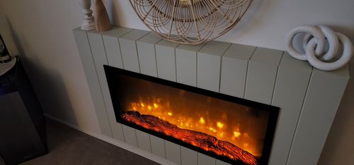

Thanks for your message, there were definitely a few challenges with limited tools at home, for example carefully using a specific wood drill bit to carve out the recesses for the magnets to fit into for the removable panel where the heat comes out at the top of the fireplace. With a 6mm depth needed from a 10mm deep panel, there's not much room for error!Also the frame sits on 4 internal legs which sit on the top of the actual fire to give stability, and negate the need to attach/drill into the wall. The removable glass panel on the front of the fire keeps the surround secure and nicely pushed against the wall.
