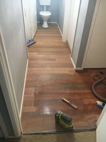

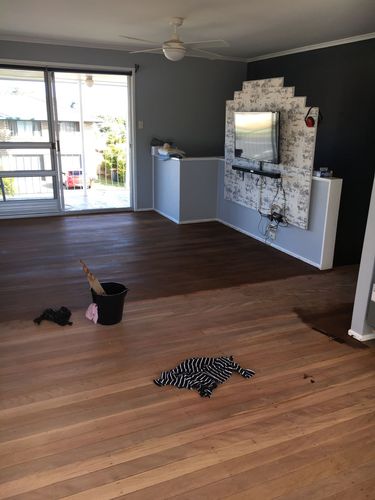

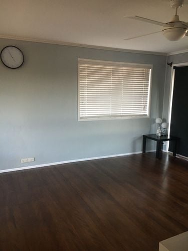

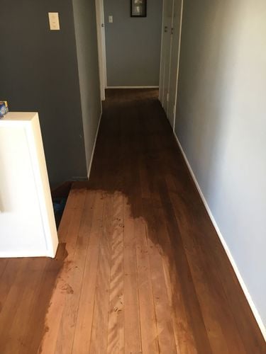

I decided to tackle the task of sanding my timber floors. They were looking tired and well worn and a bit like me needed some TLC. I found it very therapeutic hand sanding the edges with whatever worked in the beginning. Thanks to my RYOBI One+ belt sander, corner sander and an orbital sander I began with all of the edges and the smallest areas (e.g toilet) where I knew the floor sander I hired from Bunnings wouldn’t fit. Then a full 24hr hire saw me achieve the beauty of raw timber floors. Even though they were beautiful I was chasing a warmer feel so decided to stain them with a walnut stain followed by 2 coats of Estapol. Tough job but such an accomplishment for me!
