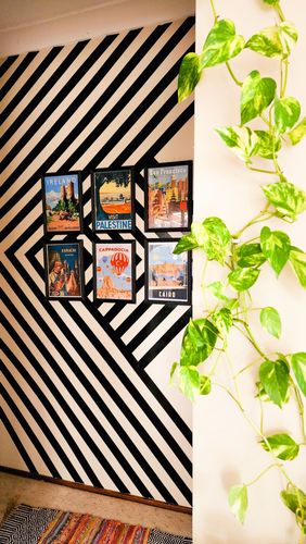

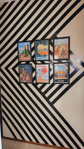

Sharing a weekend wall makeover. Yo udont need any power tools for this and best part is, you can remove it if you get over it (do patch test on your walls)
To make over this wall I used:
- cloth tape
- Stanley knife
- Measuring squares
I sketched out a rough design and used the tape on the wall. I went with the design I had in mind and used another piece of tape as a spacer to make sure the lines were equidistant.
Used a measuring square to make sure every line was at the same angle and a sharp Stanley knife to trim the ends.
You can remove tape to reposition it a few times.
And that's all. It's a quick project (especially if the wall is smaller) and makes a statement .
