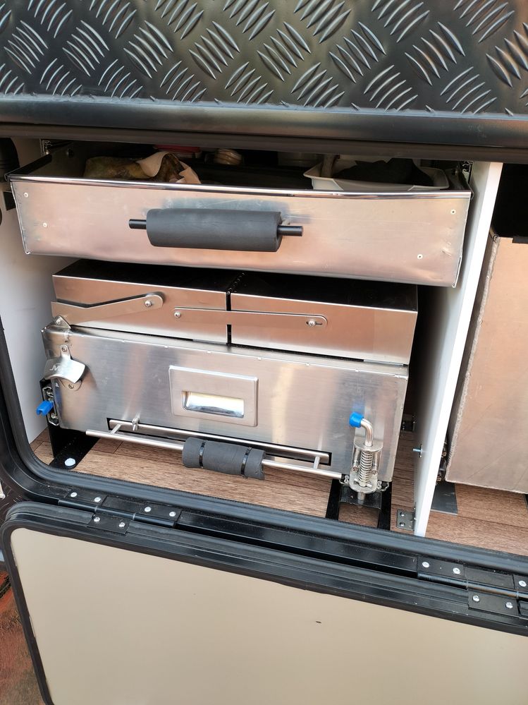

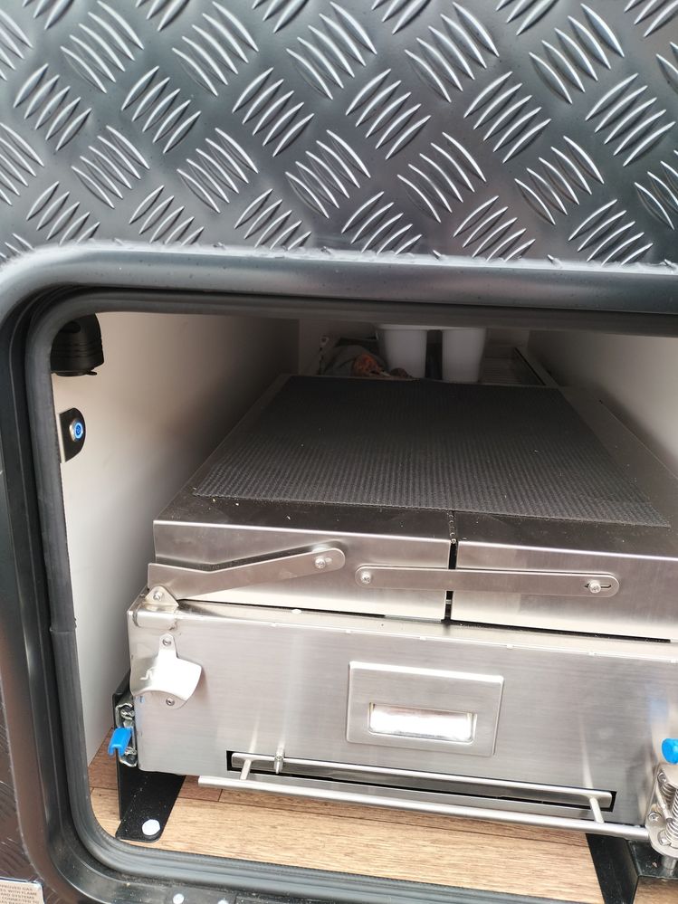

I made an aluminium drawer to sit above the stove on our caravan. There is a large tunnel boot on the side of the van. The stove pulls out and there was a gap above it.

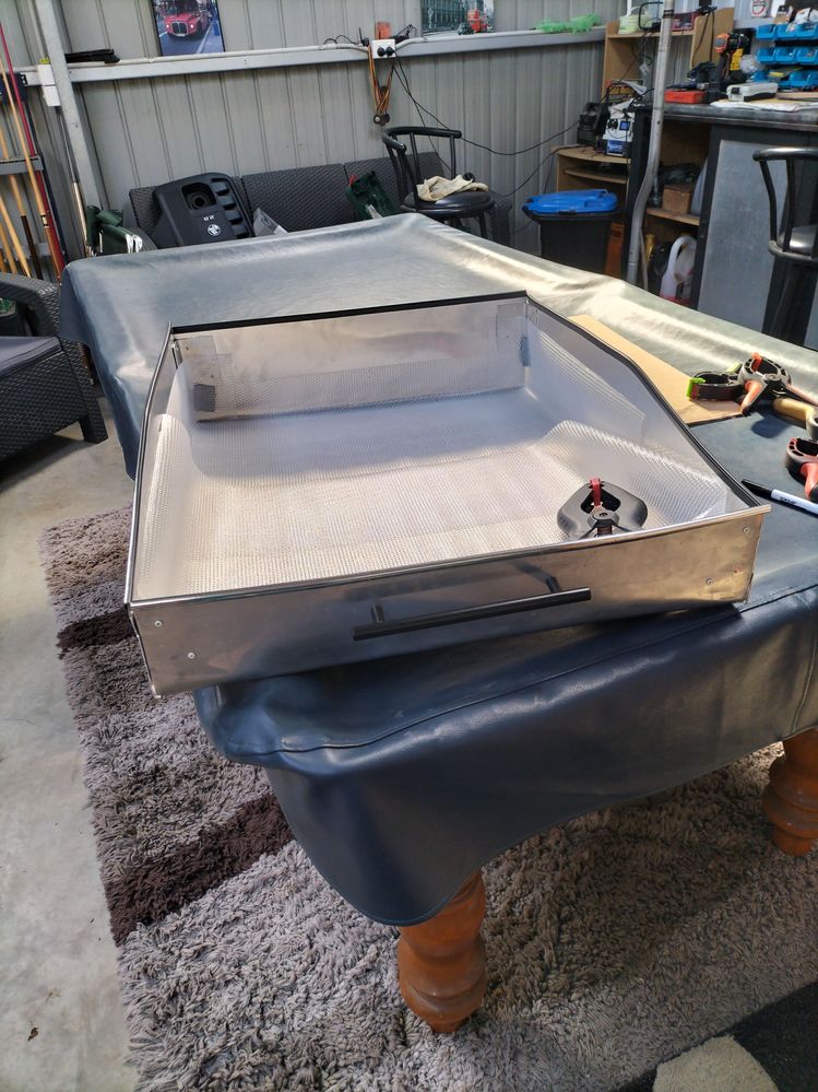

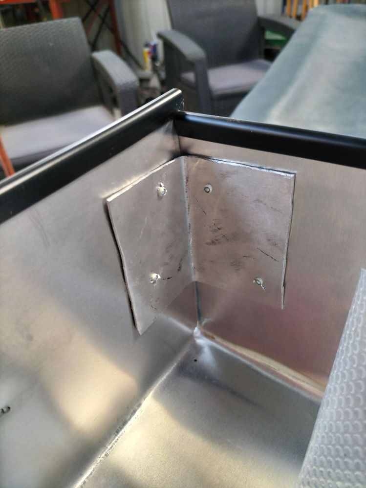

I bought a sheet of aluminium, cut it with a hack saw and Tin snips so that it was in the shape of a cross. I bent the sides up using a multitude of garage items and a Mallett. I found it easier to bend it down but it became more difficult on the last side, the front, so I sort of cut across the last side (?scribed) and that helped and gave a neater finish. I then made angles from the spare aluminium and rivetted them on the corners. Applied some edging to the top so it was neater and then put it in the space using drawer sliders. A handle went on the front and foam to protect the door of the boot tunnel and keep it still. My husband helped me with muscle and all the difficult bits, especially putting on the drawer slides. It turned out really good, was cheaper than buying over and we felt very proud of ourselves.
The attached photos show the progress and the before shot.
