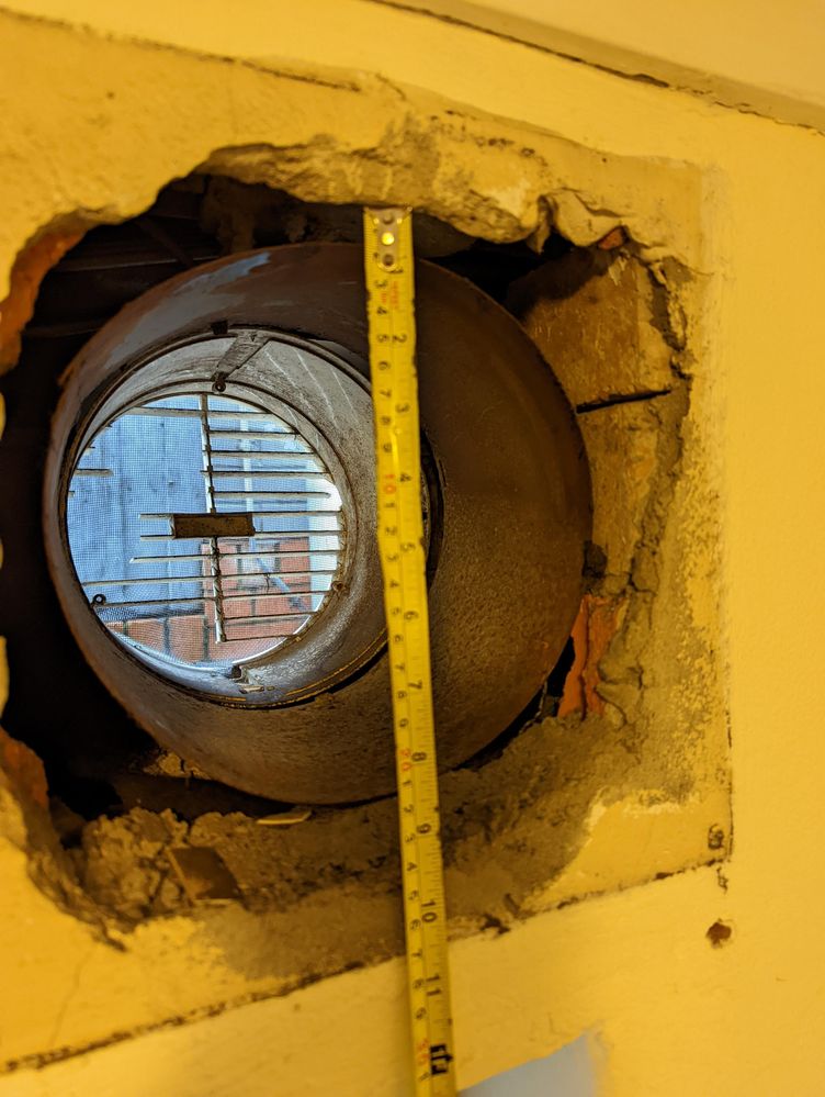

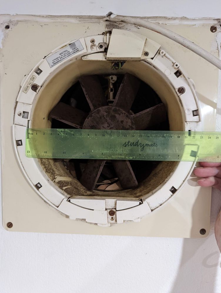

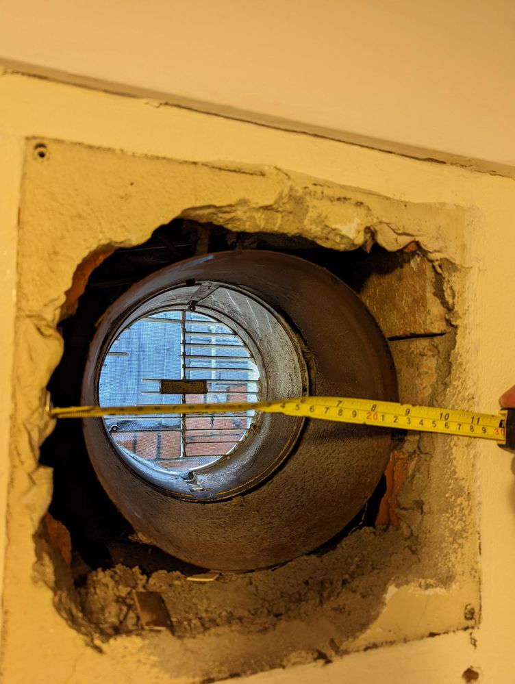

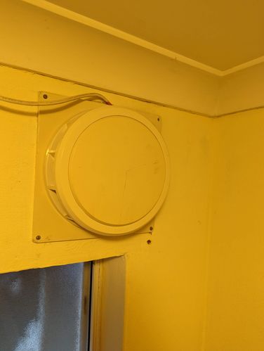

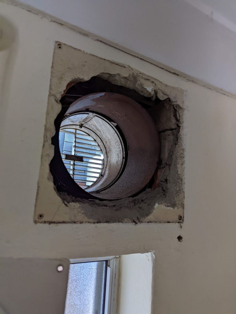

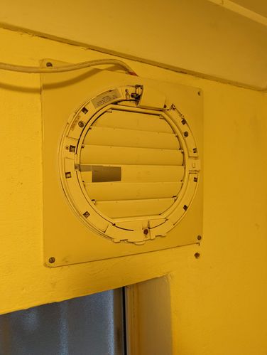

I have 2x old Mistral wall exhaust fans that have a 300 mm x 300 mm shroud going through a 220 x 230mm hole to the outside of my home. I can only find 150mm exhaust fans at bunnings. Both these fans died a long time ago (they just rattle whenever you turn them on) They really need to be replaced.I'm looking for advice as to what my options are? should I attempt to fill in the internal wall holes to make it a 150mm hole or should I try to source a like-for-like replacement? It looks like this product wouldn't even cover the massive hole that was made in the wall to accommodate these older fans. https://www.bunnings.com.au/blauberg-150mm-white-aero-wall-ceiling-exhaust-fan_p4420505Here are some photos that show the issue I am dealing with.

Hi @joejoeinc welcome to the community. You certainly have yourself some old school wall fans there and someone had fun installing them.
You have 2 options.
1. As you say purchase the same size wall fans and there are some much nicer and stylish looking ones out there of that size just do a google search.
2. You install some new plates and cut new holes to suit a smaller wall fan and mesh covered flap vent on the outside. I would probably fill in the outer of the pipe between the brick and the pipe with some expanda foam just to make sure the draft only went through the pipe and not the brick cavity.
