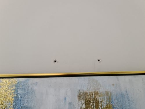

How to fill these holes and make them into original status (wall with paint).
Hello @rohit21
Thank you for sharing your question about filling holes in your wall. Since the holes are quite small you can easily fill these with Selleys 180g Spakfilla Rapid Gap Filler. There's no need for you to use a reinforcement patch because the holes are not that big. I recommend filling it to just about the same height as the wall. Once the filler has cured, I recommend sanding it down to the same level as the wall.
I suggest picking up a Coloursmith Window By Taubmans and downloading the Coloursmith App on your phone. Simply follow the step-by-step instructions on the app to let you colour match your wall colour.
Here is a handy step-by-step guide: How to fix a hole in the wall.
Other than the reinforcement wall patch everything else on the guide is applicable to your repair project.
