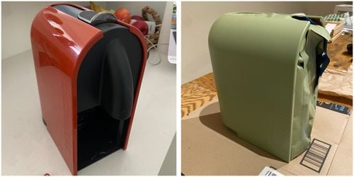

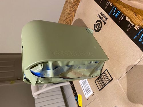

I got this coffee machine as a gift many years ago. While I love the coffee, I’ve never loved the colour. So I thought, why not make it feel more like mine. Here’s what I did to get the look:

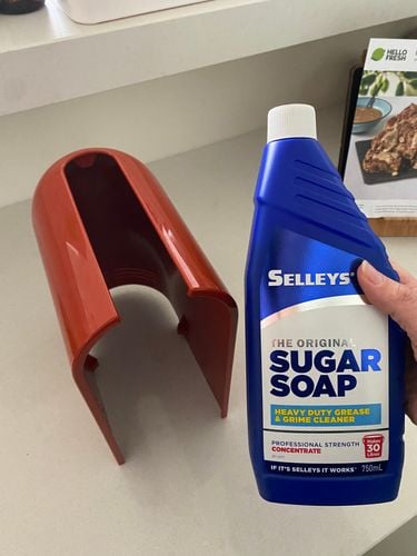

1. Remove the cover and sugar soap.

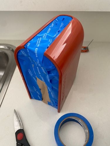

2. Lightly sand with a 320GRIT sponge suitable for plastic, wipe with a dry microfibre cloth.
3. Use cardboard or a drop cloth to protect your surfaces from overspray, tape to avoid getting paint on the underside of the cover.

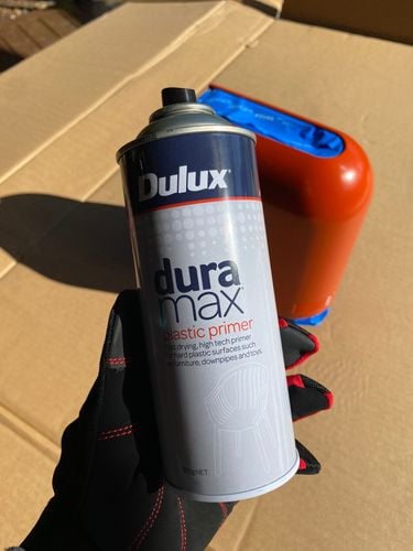

4. Shake plastic primer spray for 3 mins, then lightly mist - not too heavy. Allow to dry.

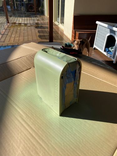

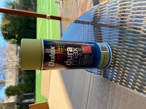

5. Shake enamel paint spray for 3 mins, then lightly mist. Don’t worry if patchy, keep paint coats light. Repeat once dry for 2-3 coats. Allow to dry.

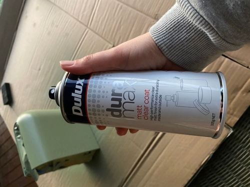

5. Shake clear coat spray for 3 mins, then lightly mist.
6. Allow to cure before reattaching to the machine.
