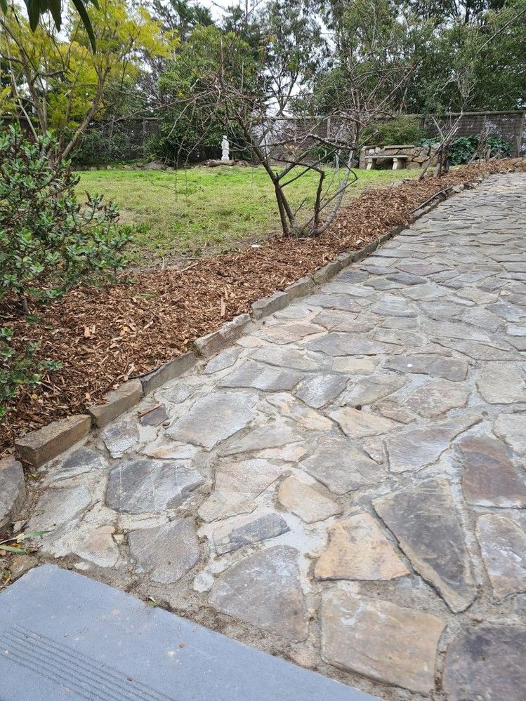

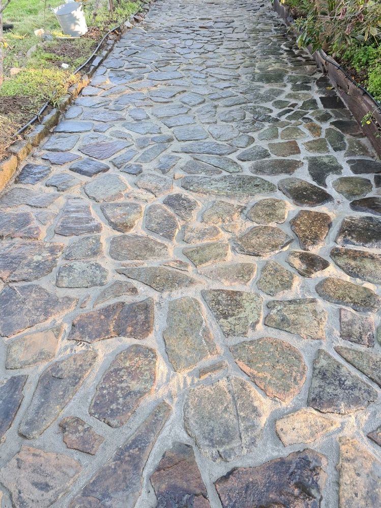

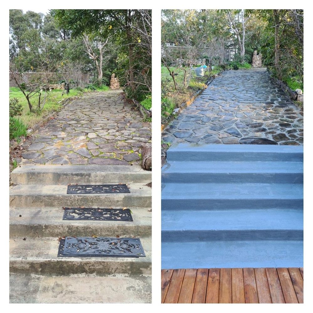

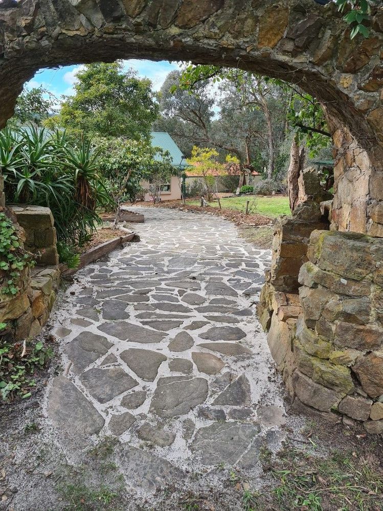

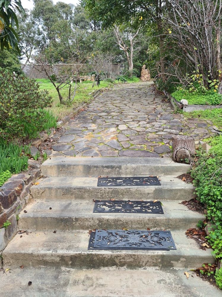

Old pathway was trashed with weeds and rot, pressure washed off all the edges around the stones. Mixed paving sand and cement at a ratio of 5:2, added a little pigment powder, Brushed into all edges, cleaned throughly with a dust brush, sprinkled water over to set. The next day gave a thorough scrubbing on stone faces. Used concrete paint on steps to freshen up
