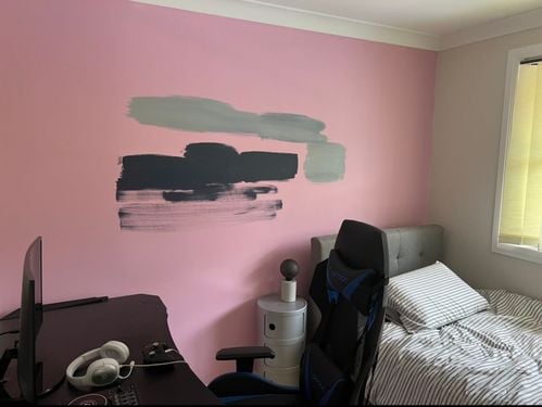

So having moved into my new home 6 months ago, I was well overdue to tackle my youngest sons room, as his current set up featured a pink feature wall and he was not a fan!!
After checking out a few different designs I settled on a geometric pattern which was somewhat random, but quite bold and I thought it would really appeal to my boy.!
I next selected a few paint samples…I ended up going with the dark blue porters paint for the main colour and the dulux gold for the geometric shapes.

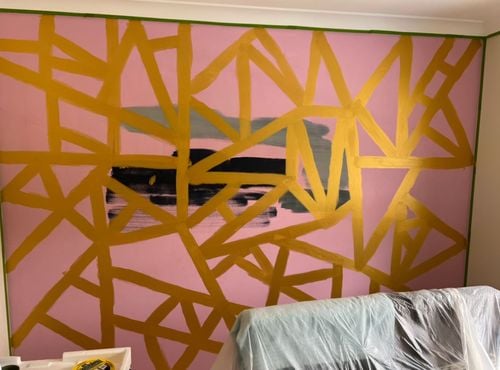

Next was to sketch on the geometric pattern and paint this roughly with the dulux gold, which I hoped would pop out nicely from the matt finish of the dark blue.. As I was going over the existing paint, several coats were needed to get the texture and thickness I thought was needed for the lines in gold.

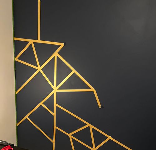

Once dried, it was then it was time to tape over the gold lines which would make them thinner and give them the precise and neat edges I was looking for.

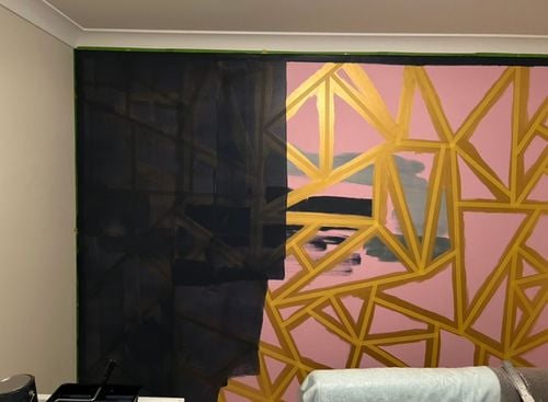

Then it was time to paint over everything in the dark blue, applying two coats.

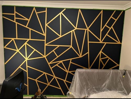

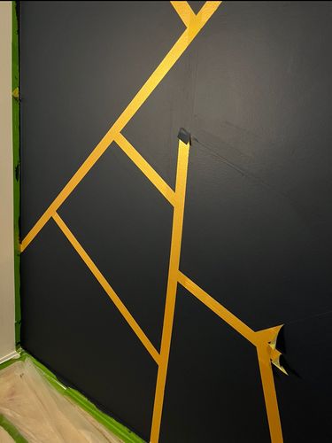

Once fully dried, pulling back the first tape was nerve racking but I was thrilled with the result, strong crisp lines of gold remained!
once fully revealed it was time for a couple of touch ups and it was ready to furnish!!
My son was blown away by the result, and I gotta say I was pretty chuffed too. Amazing what a few coats of paint can do to change the whole vibe of a space!!
