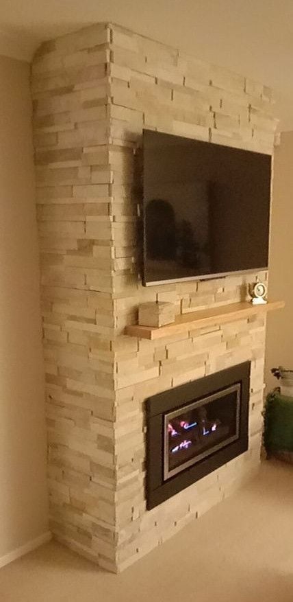

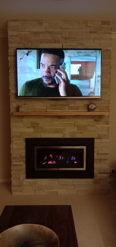

Stacked stone created a wonderful feature for this living room.

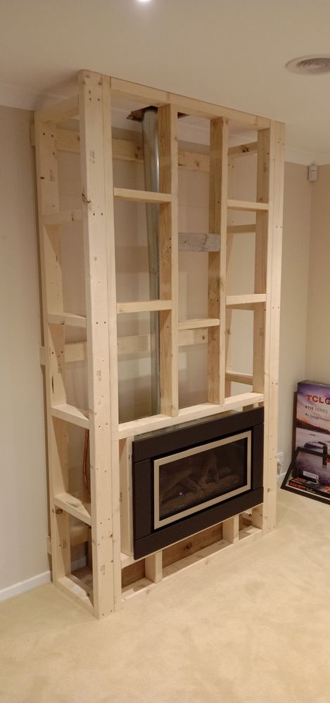

This one was fun to knock down – I finally completed the last room in my house, which had been empty for four years.

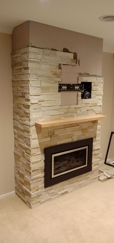

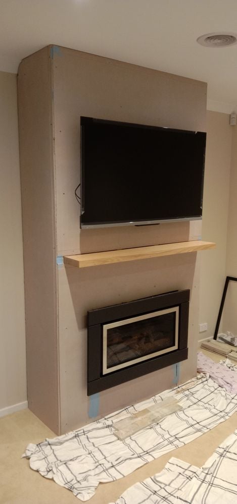

The fireplace was quite straightforward to build: timber frame, cement sheet and stone cladding. The gas heater was installed by a qualified tradie.
The cutting of the stone was a nightmare in the sense of the mess that it makes. I did all the cuts in the garage and everything was covered in dust.
The best advice I can give is to have a good-quality masonry cutting disc for a small grinder. It makes cuts much easier.
I splashed some cash on some furniture and it's the perfect spot once the kids go to bed!
