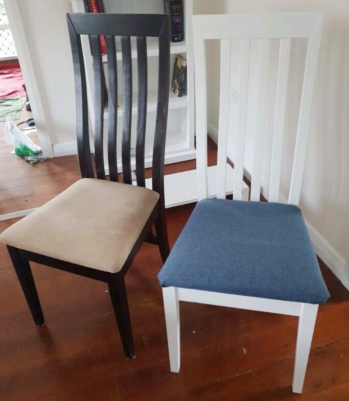

Thanks to lockdowns I had plenty of time to complete this chair renovation project.

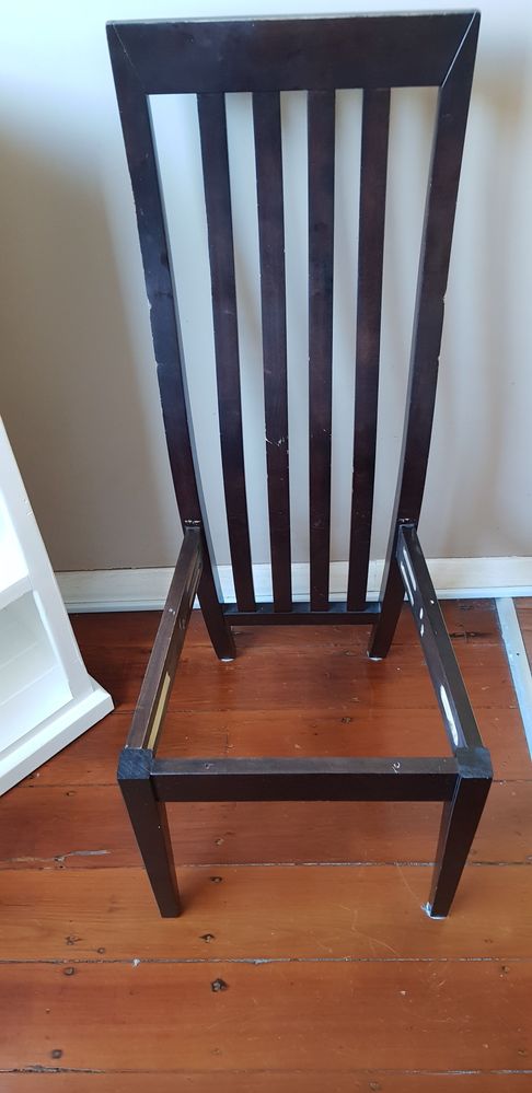

It was pretty simple to remove the chair bases – four screws held them in place.

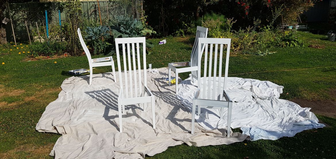

I then scrubbed the chairs with sugar soap and a kitchen scouring pad, let them dry and then lightly hand sanded with some fine sandpaper.

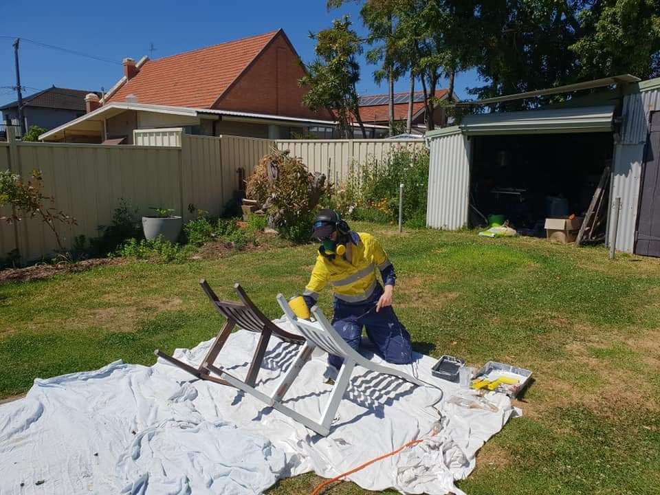

I used a spray gun to apply two coats of Dulux 1Step Prep primer, then two coats of Dulux Aquanamel semi-gloss. There is a bit of overspray so don't forget the respirator and safety glasses!

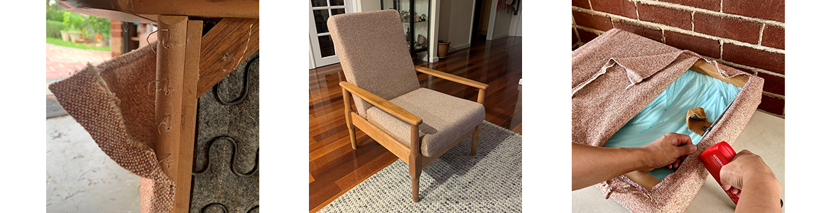

The upholstery had been secured with about 60 staples per cushion. It was a bit of a mission to remove the staples to get the old fabric off because the staples were well embedded in the upholstery.
Eventually I settled on a sharp 10mm chisel, which could get right under the staples, and some pliers for any stubborn ends.
Once the staples were removed it was a matter of cutting the new fabric to size and securing the new fabric with a staple gun.
