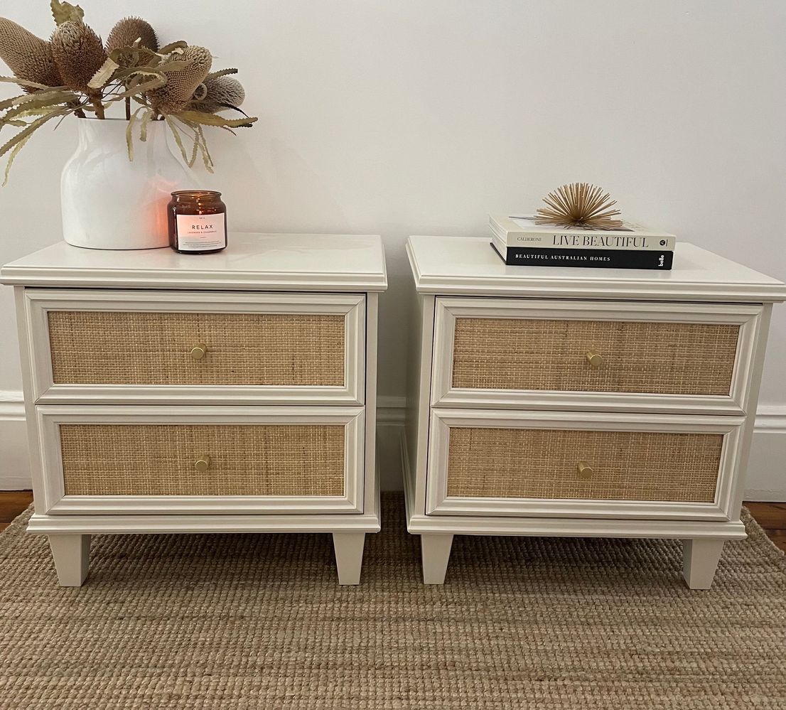

After

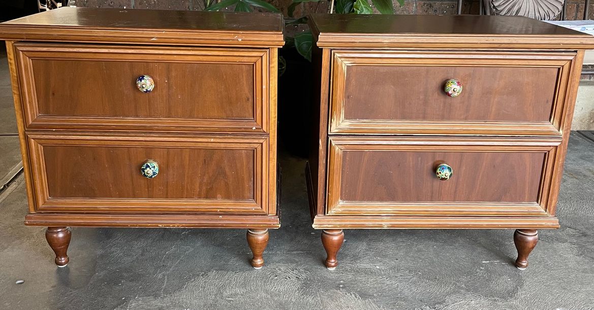

Before
After buying these bedsides from Marketplace, I gave them a thorough clean and removed the existing hardware. I then scuff sanded all surfaces and filled any scratches and dents with Timbermate wood filler. I wanted to give the bedsides a more modern look, so I decided to remove the original legs and replace them with Adoored pine tapered furniture legs. I also added rattan to the drawer fronts, which I cut to size, soaked in warm water for 30 minutes before fixing onto the drawer fronts with Gorilla Clear Grip glue. After doing this , I primed the bedsides with BIN shellac primer and once dry, I painted them with Dulux aqua enamel in Hog Bristle Half. Lastly, I added Lane Matte Brass Finger Post knobs to the drawer fronts. I was happy to give this tired pair of bedsides a new lease on life!
